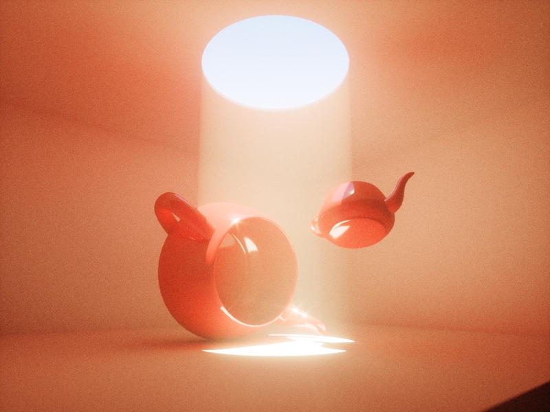

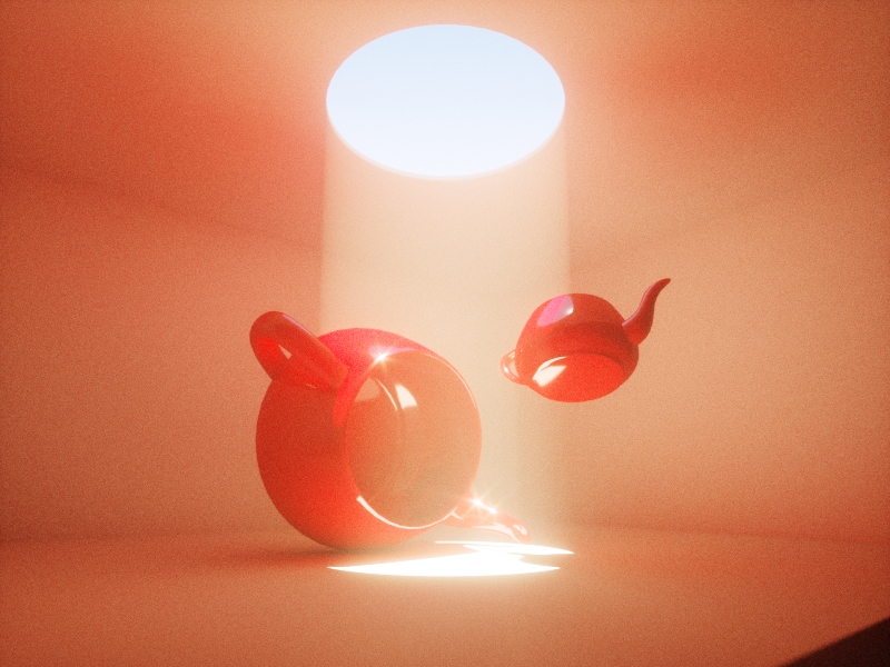

I also found some bugs (both related to the new fake_shadows/Octane Fog algorithm).
1. Incorrect Illumination inside volume
First: here is a scene with a fog volume showing correct radiosity from the sun hitting the objects. Objects are colored red, glossy, IOR = 2, reflection set at 1.0
Second: here is the same scene with Objects (still colored red), glossy, IOR < 1, with reflection set at 1.0
Somehow the red color is being reflected even though the object doesn't have a "color" anymore because of the reflection properties.
Third: here is the same scene as above, with the fog volume removed, showing correct lighting.

profbetis wrote:I also found some bugs (both related to the new fake_shadows/Octane Fog algorithm).

What kernel do you use Direct Lighting?
With path tracing and PMC it should work fine.
Regarding camera aperture. How Do you set fog volume? By small plane before camera? very likely that aperture disk is out of that small plane or it get inside of volume geometry.

@Karba: This was in PMC mode at depth 8, higher does bring in more white, but the problem persists.
I have attached the scene file in a zip.

Hi, profbetis thanks for your scene, the problem you have is the box with material fog is must to be more bigger than walls and ceiling.
