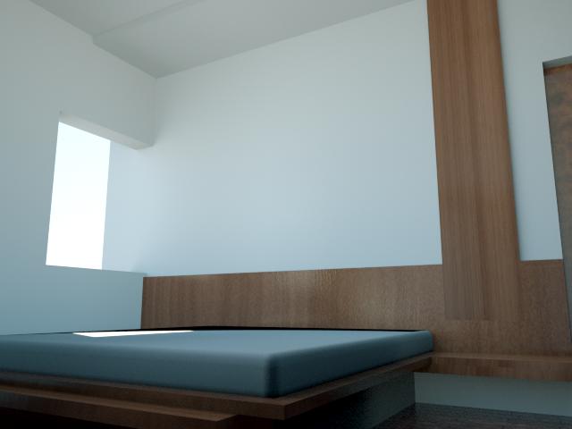

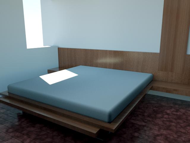

IES does not work for me too...another small bug I found..check out the end of the mattress in both the image...as I take my camera lower the mattress (chamferbox) turns black on the ends..
gabrielefx
Posts: 1701
Joined: Wed Sep 28, 2011 2:00 pm
3rdeye wrote:IES does not work for me too...another small bug I found..check out the end of the mattress in both the image...as I take my camera lower the mattress (chamferbox) turns black on the ends..
Hi, I know well this issue.
Smooth shading in Octane doesn't work like in Vray for example.
You have to subdivide your mesh and then apply a smooth shading operator with 15-30-60 degrees
Dark surfaces can appear if you use high roughness glossy mats and you render with a camera positioned at extreme low angles respect the surface.
In this case the roughness component of the glossy mat can be created mixing a diffuse+glossy material.

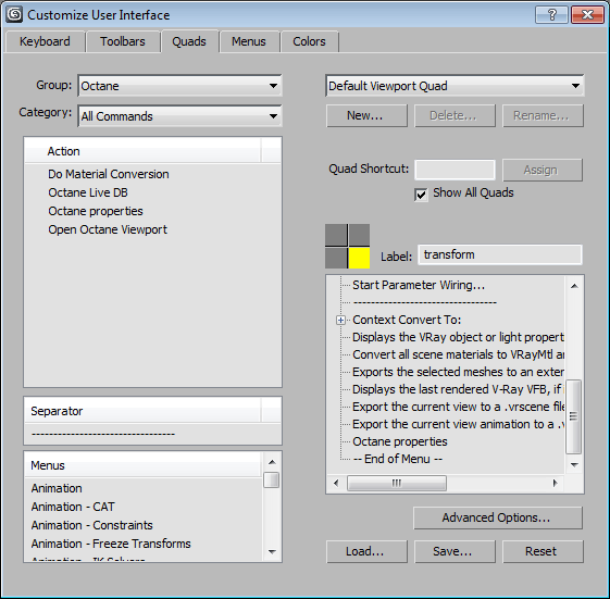

HHbomb wrote:hello
1) I don't find OCTANE in customise menu
2) how to render trees with forest lite (i can just show proxies) or need forest pack ?
3) could it be possible to use multiscatter with octane one day ?
4) ooppps : one crash...
1) Please see image. Some times 3dsmax hold plugin loading. You can just click to Rendering menu to force 3dsmax to load it.
