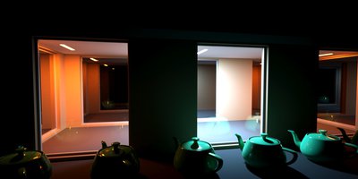

Karba
Posts: 2300
Usefull material for windows glass based on glossy material and falloff textrue.
It allow to pass light even with diret light kernel or sun light.
thinGlass.zip
(21.37 KiB) Downloaded 273 times
