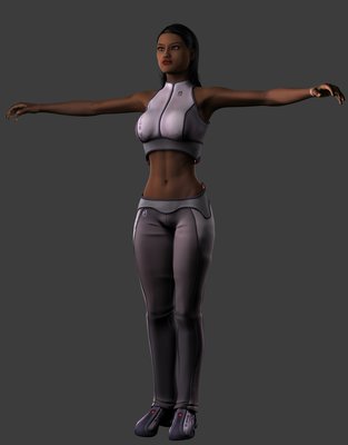

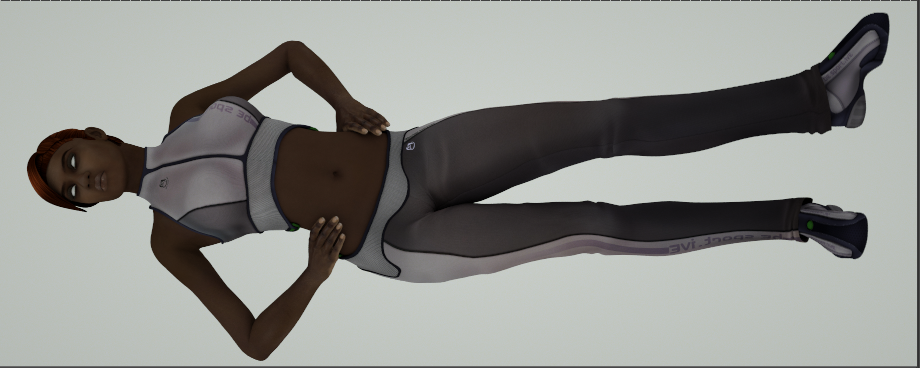

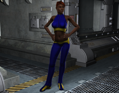

Here is an example. The top image is output from Octane. The middle image is output from DAZ Studio. I retextured the outfit using DS materials that I purchased. Notice that the only items that changed on export (except for her eyes, which Tugpsx has addressed in another thread, and the hallway she's standing in -- that's another story) were the green beads on the shoes and at the bottom of the top. Everything else remained the default color of the outfit (which you can see in the last image, another render from DS).

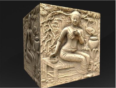

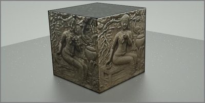

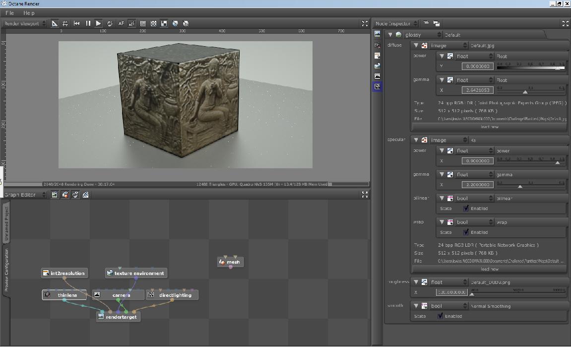

Here is a baked texture on a cube
BTW that's how to get around the HSS issue.
Yes! it's actually just a simple 2x32 cube with Normal mapped texture baked on.supercope wrote:You did this in DAZ Studio?
Grab ShaderMap Pro, it's cheap and creates great normal maps for these kinds of projects.
