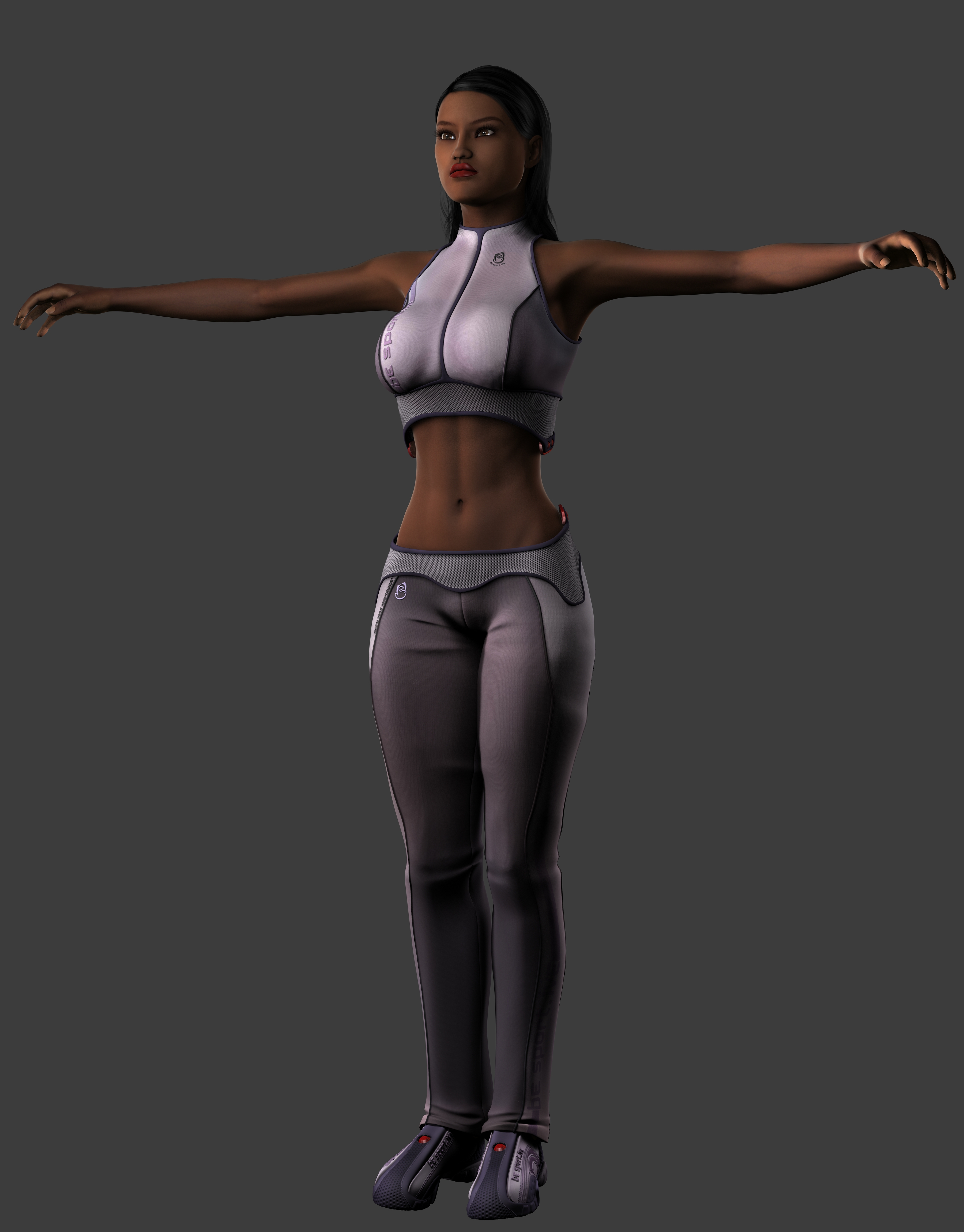

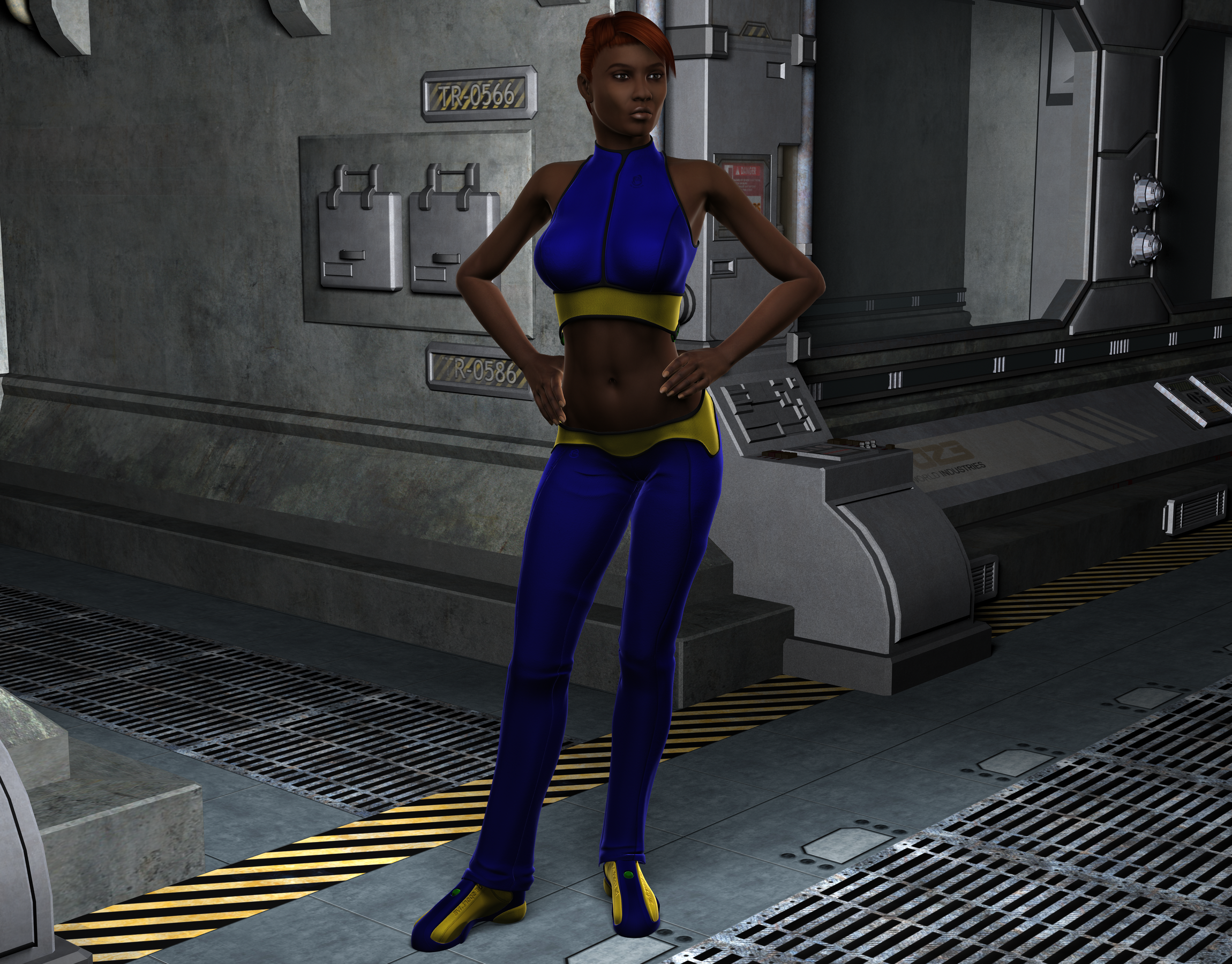

supercope
Posts: 13
Joined: Sun Jan 24, 2010 10:35 pm
Here is an example. The top image is output from Octane. The middle image is output from DAZ Studio. I retextured the outfit using DS materials that I purchased. Notice that the only items that changed on export (except for her eyes, which Tugpsx has addressed in another thread, and the hallway she's standing in -- that's another story) were the green beads on the shoes and at the bottom of the top. Everything else remained the default color of the outfit (which you can see in the last image, another render from DS).

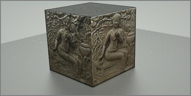

Nice job, to get the look of the textures use the spec map in your spec channel or if you want to you can bake them in a copy of the textures.
BTW that's how to get around the HSS issue.
Here is a baked texture on a cube
Texture setting
Texture setting
Normal Map from Shadermap Pro
Octane 81a render
Octane 81a render

Tugpsx
Posts: 1160
Location: Chicago, IL
supercope wrote:You did this in DAZ Studio?
Yes! it's actually just a simple 2x32 cube with Normal mapped texture baked on.
Grab ShaderMap Pro, it's cheap and creates great normal maps for these kinds of projects.
