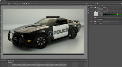

Some new stuff, and i've got a problem- glass. I've managed to get somewhat correct windshield, but those headlights give me an headache.
It's glass surface is two-sided, it has thickness. But i simply cannot manage to get light through it. Not sure what to do...hmm
Win7 x64::[email protected]::4GB::Asus GTX460 DirectCU::8800GT
A ray arrives, get's refracted twice, then it's inside the light, so it needs to hit a reflective surface (like diffuse or glossy) then refracts twice again outside and needs to find the sky.
So use pathtracing and set your maxdepth 8 or higher, and make sure you're normals on your headlights are pointing outwards on both sides, and make the interior of the light reflective.
directlighting does'nt do this, only pathtracing.

Thanks a lot. That helped.
I've searched for all other stuff related to glass, and i missed that
