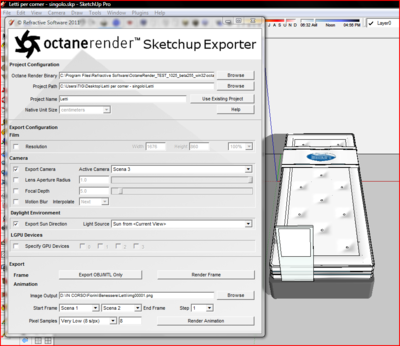

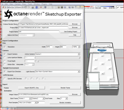

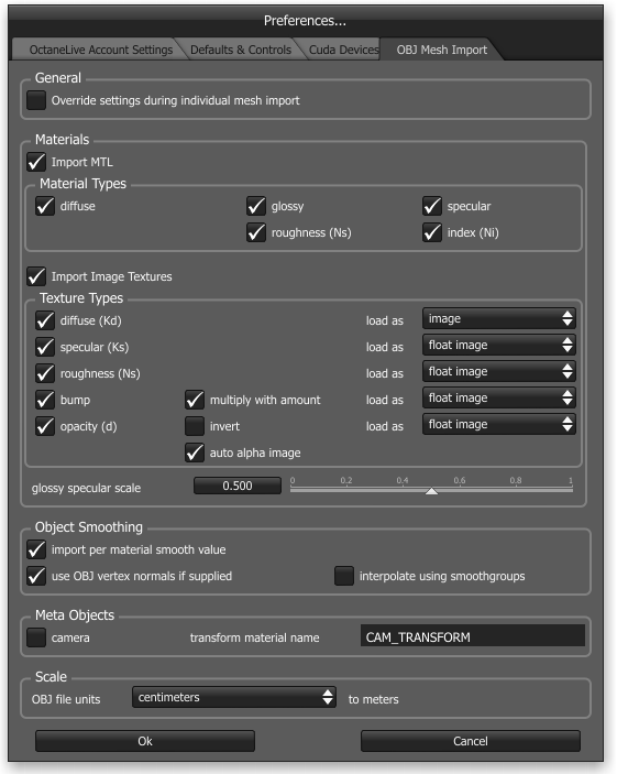

Did you set the Exporter's dialog setting to export the Camera as well as other settings ?
Post a screenshot of the dialog you use and with which you don't get the result you expect...

Your screen-shots were not attached properly.
Is the blue/Z axis 'up' in the SKP ?

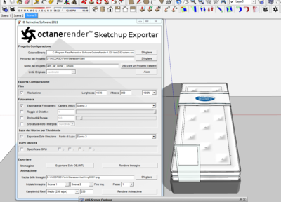

						TIG, even with other files. Skp
the Camera is not exported Octane...
