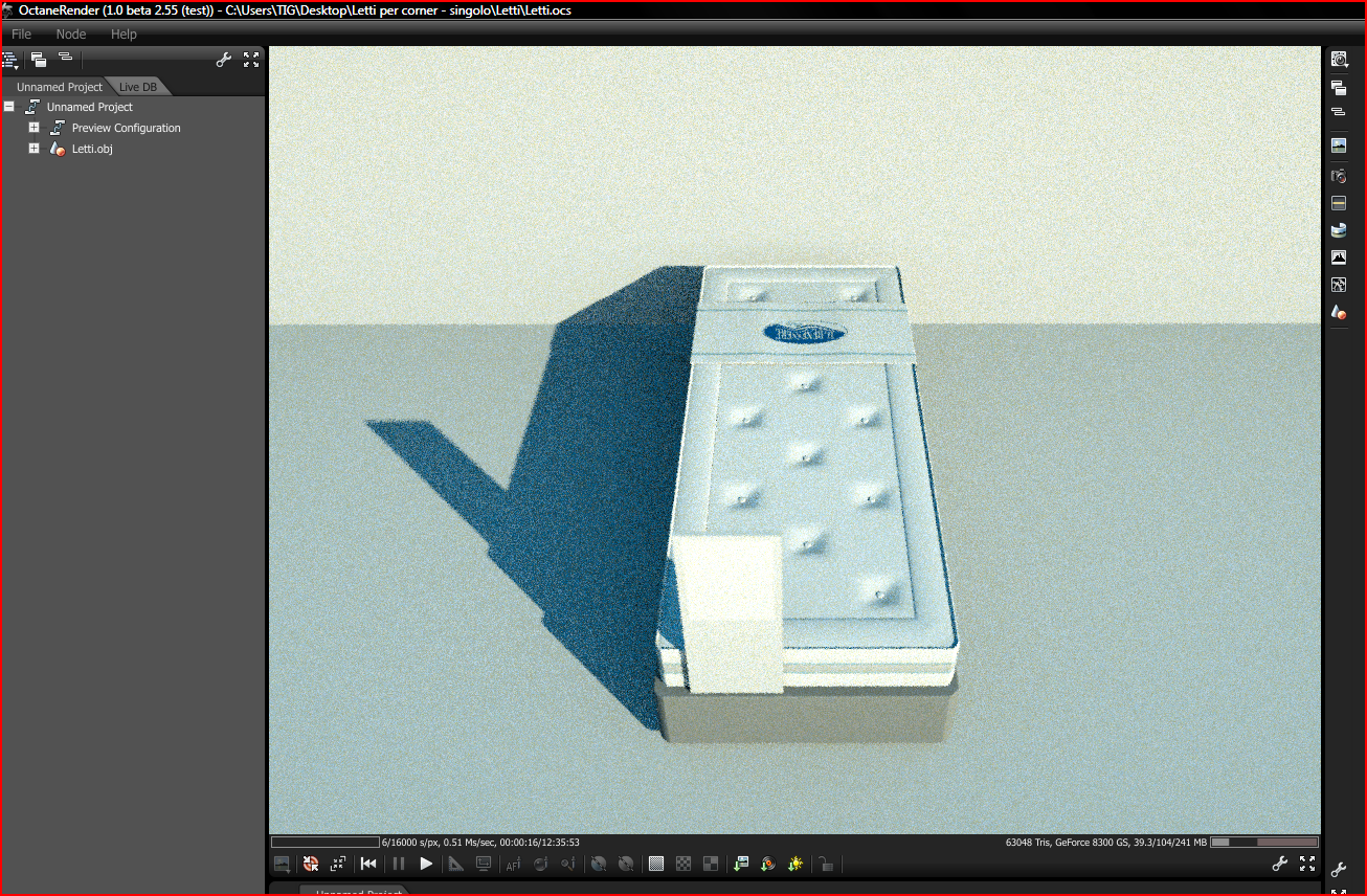

Postby TIG » Sat Nov 05, 2011 10:46 pm
TIG Sat Nov 05, 2011 10:46 pm
I received your SKP by email.
I tried it and the results are OK for me...
With no resolution set
and with resolution set as the screen
Can you post a screenshot of your Octane settings ?
Here are mine...
