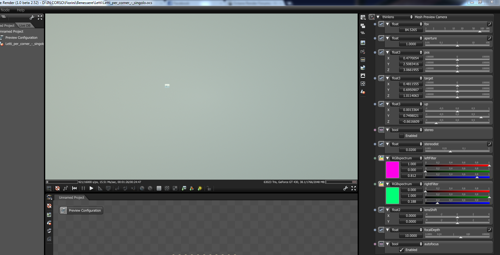

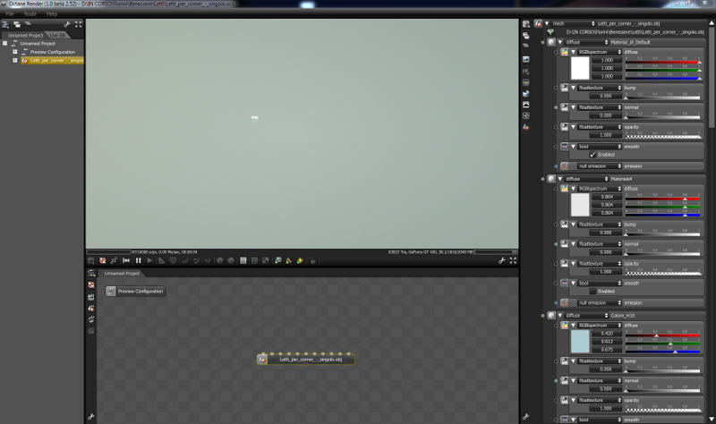

Even with 1.24 does not work ...
I attach screenshots,
thanks
kind regards
(Sorry my english is not perfect)
opening at Octane
Export Scena/Camera SU

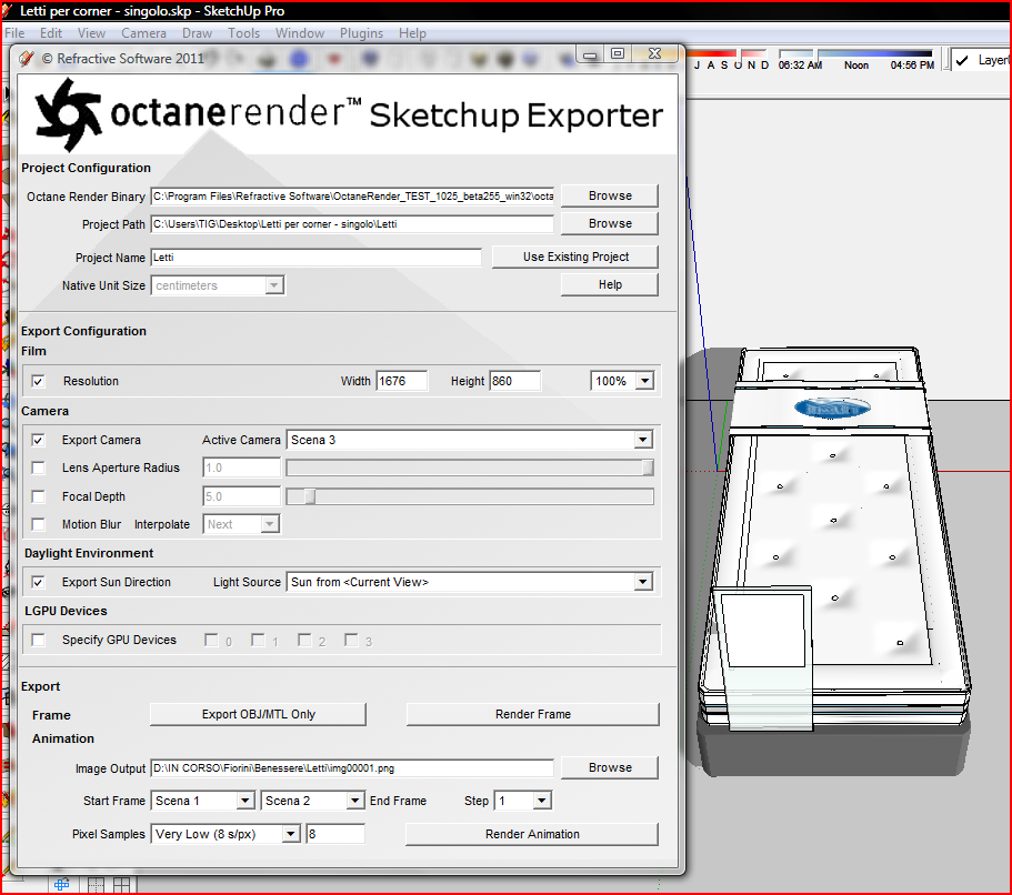

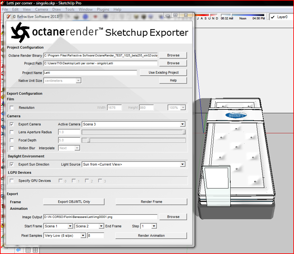

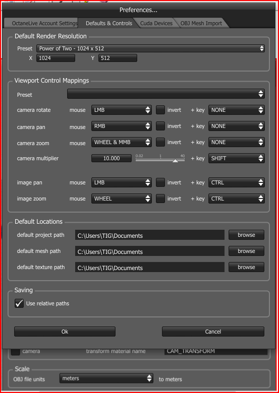

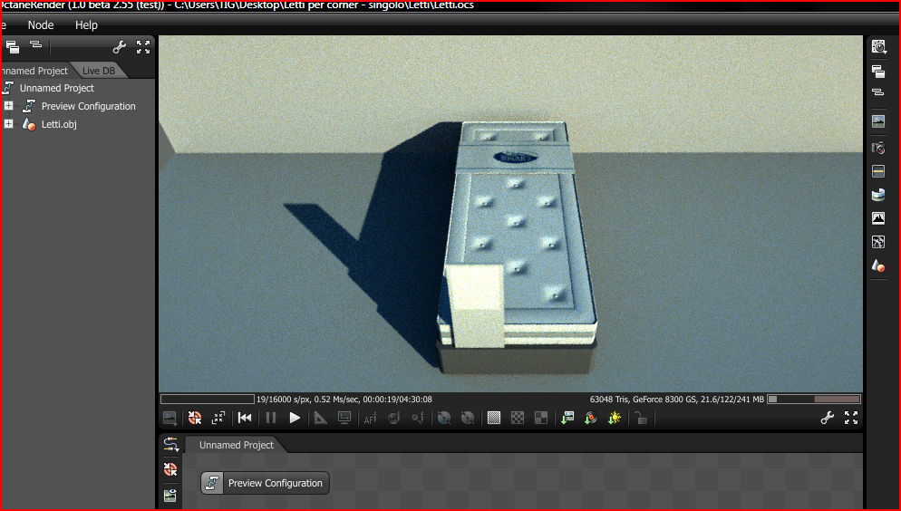

Postby TIG » Sat Nov 05, 2011 10:46 pm
TIG Sat Nov 05, 2011 10:46 pm
I received your SKP by email.
I tried it and the results are OK for me...
With no resolution set
and with resolution set as the screen
Can you post a screenshot of your Octane settings ?
Here are mine...
TIG
TIG
Posts: 536
Joined: Wed May 12, 2010 1:25 pm

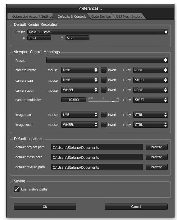

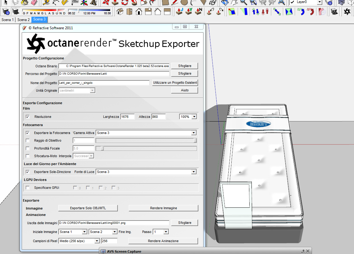

Postby Natato » Sat Nov 05, 2011 10:55 pm
Natato Sat Nov 05, 2011 10:55 pm
I attach 2 screenshots...
(Sorry my English is not perfect)
Intel Core i7_870 | Win7 64 | 8 GB ram | GTX760 x Octane | SketchUp 2013 | GIMP |

Re: Problems export camera
Postby TIG » Sat Nov 05, 2011 11:11 pm
TIG Sat Nov 05, 2011 11:11 pm
Your OCS settings are incorrect.
They should ALWAYS be 'meters'.
You have 'centimeters' !!
ALSO many of your 'second' tab's options are NOT like mine ???
