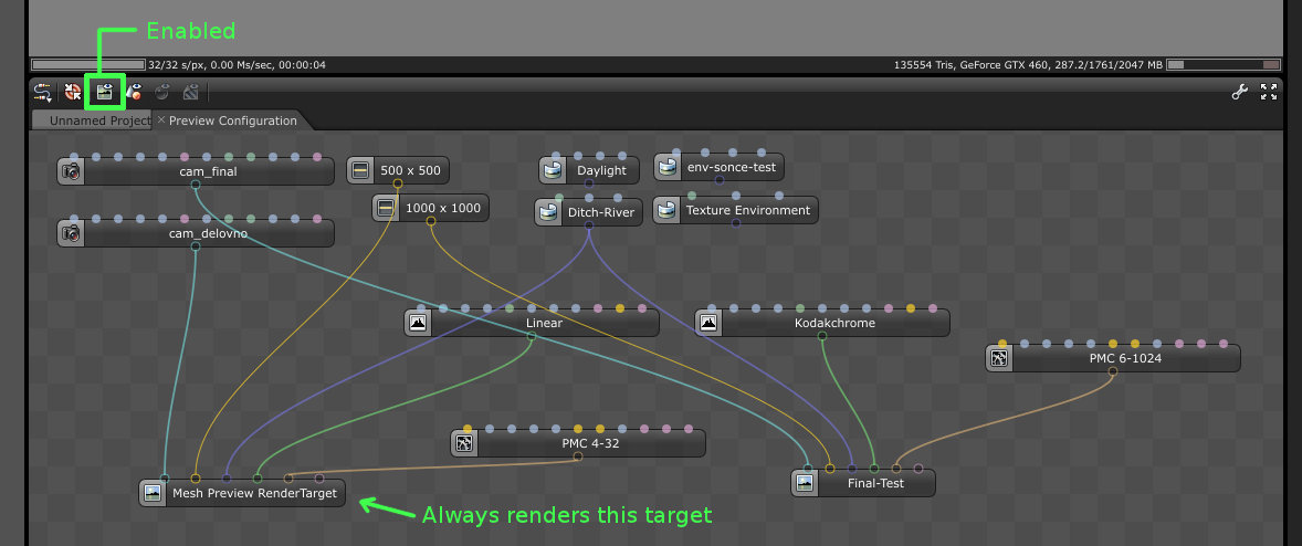

Does render target switching work in 2.52? Because I have this setup below and nothing happens if I click on the render target node that I created. The default one is always rendered, although the parameters in the NI change accordingly to selected render target.

Hi Matej,
You need to connect the object node you want to render to the last input pin of the render target node. The mesh preview render target is a special case, these settings are used if you preview a mesh node, a material or a texture.
Roeland
Roeland
Yes, that makes sense
Thanks!
