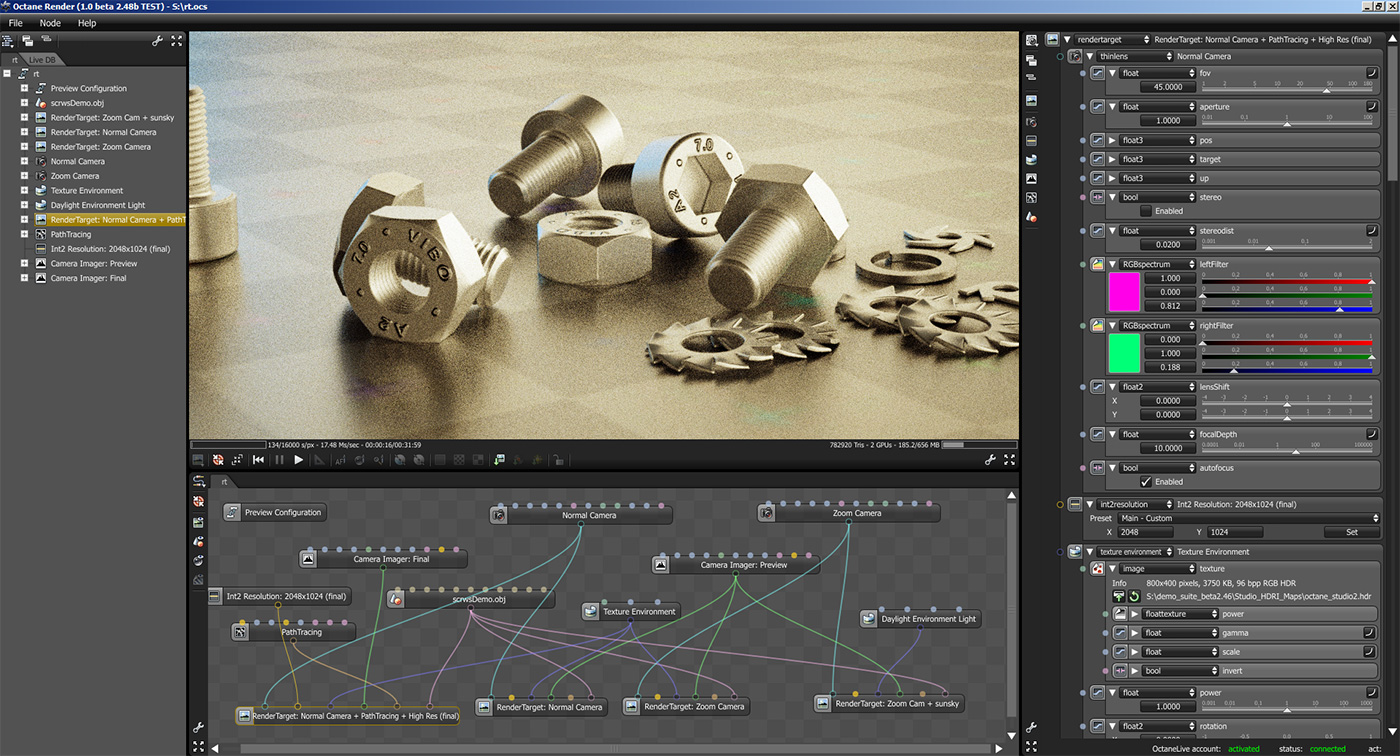

USING YOUR OWN RENDERTARGET NODES
In the following images, I have configured 4 rendertargets (by adding rendertarget type nodes, and several cameras, tonemappers etc as nodes).
The end result of this setup, is that I can simply click on any of the 4 rendertargets (bottom of nodegraph editor), to render my scene with that particular configuration.
In this scenario, going from left to right:
* RenderTarget: Normal Camera + PathTracing + High Res (final)
This is the final output quality, with a full scene view camera, pathtracing kernel, high resolution (2048x1024) and an environment HDR map.
Same as above but with default tonemapper, directlighting kernel (in the nodepin/default), default resolution (in the nodepin/default), and environment HDR map.

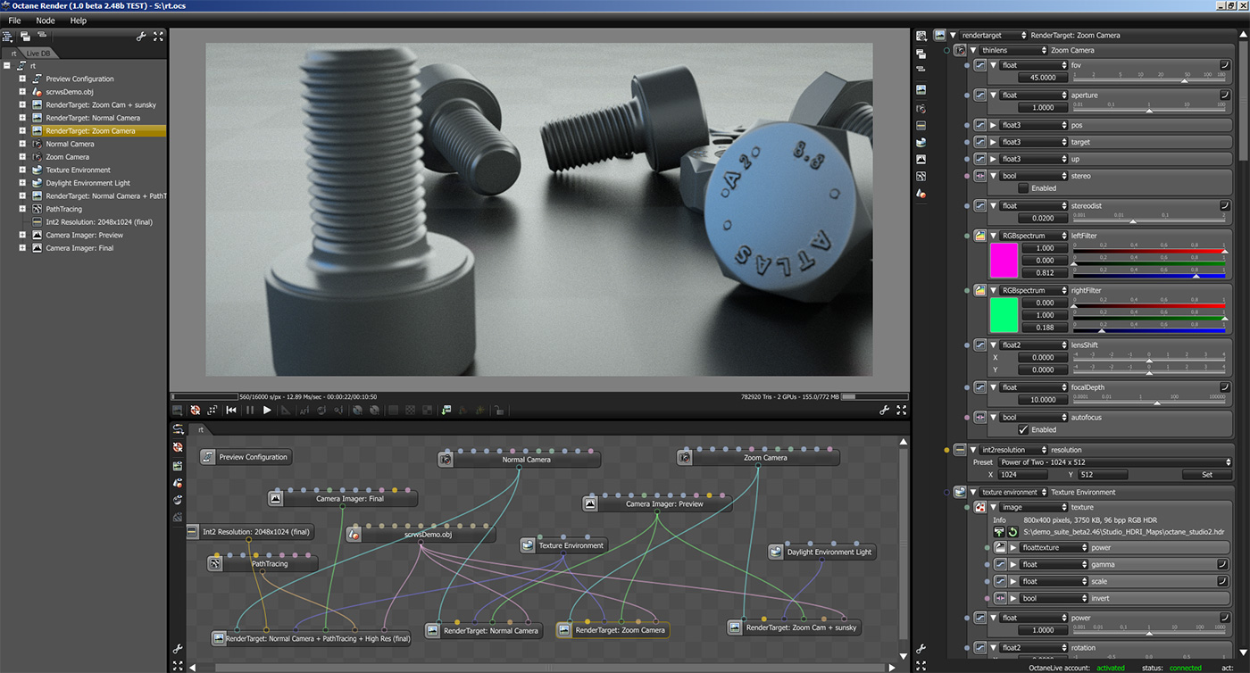

* RenderTarget: Zoom Camera
Same as above but with a closeup zoom Camera.

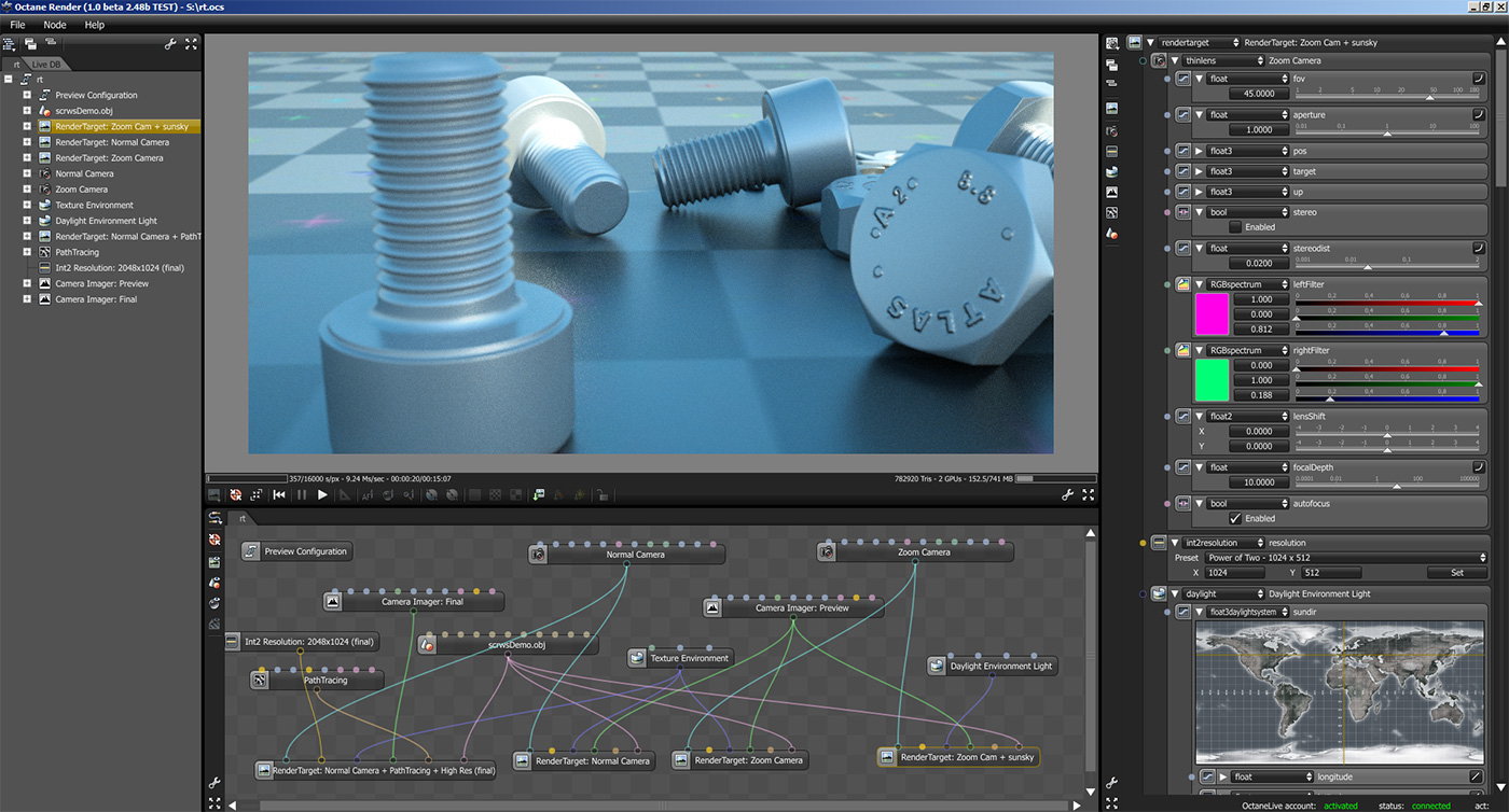

* RenderTarget: Zoom Cam + sunsky
Same as above but with a sunsky sunlight environment.
Study the nodegraph layout in the images above to fully understand, it does'nt really require much explaining, the rendertargets are connected to various tonemappers, cameras, etc..., some of them shared and others not.
Unconnected input pins (filled, not hollow) contain internal defaults (but can also be changed).
Rendertarget nodes, can be rendered by clicking on them (eg selecting), just like mesh object nodes, material nodes and texture nodes. (although they can also be filtered with the 4 filter icons in the nodegraph editor's toolbar (left).
As you can see this gives a great degree of flexibility, especially for advances scenes with multiple views, conditions, kernel settings and tonemapper options.
Further, you can set up your favorite workflow rendertargets in an empty project, and save it as Octane's default scene to always have your configuration ready when you start a new project.

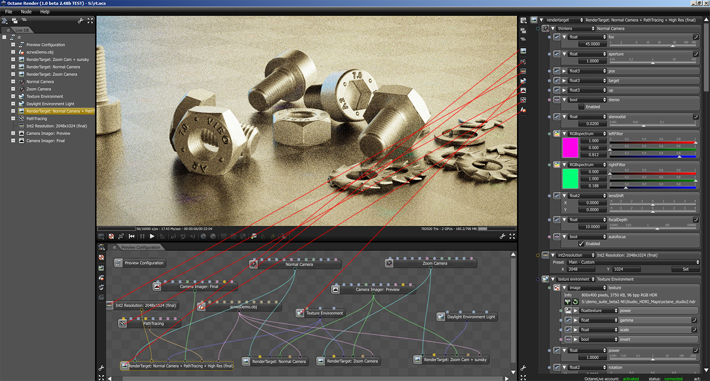

BEHAVIOUR OF NODEINSPECTOR SHORTCUTS WHEN USING RENDERTARGETS
The shortcut buttons in the vertical toolbar of the nodeinspector panel on the right, will select the currently active rendertarget (eg the one which is rendering), and the node(s) it's connected to.
Examine the following image to see how.
It's important to know that different nodes will be selected when using shortcuts, depending on the current rendertarget that is rendering, which is either the preview target (if you are 'previewing' a mesh, material or texture) or a custom rendertarget.

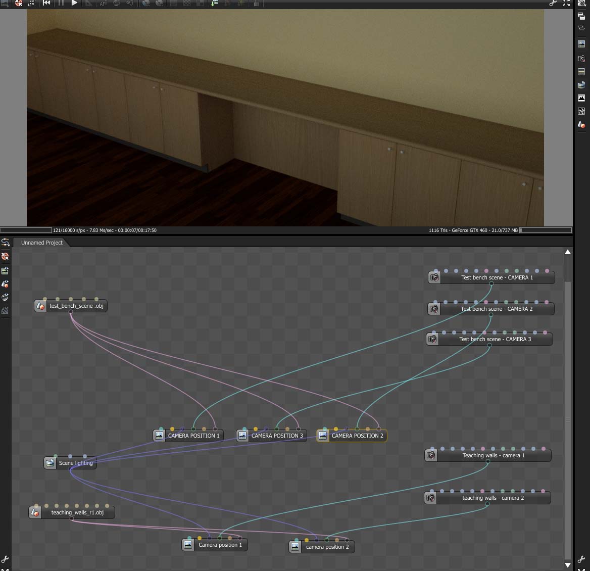

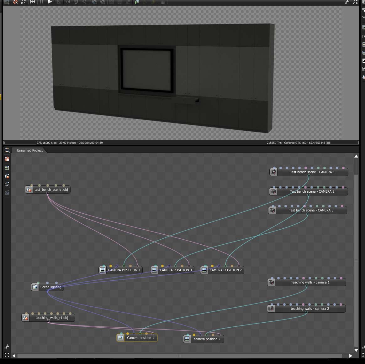

Thanks for the insight. thought i would try this out....but slightly extreme.
I loaded 2 different scenes into one...an old test bench scene and a teaching wall scene.
I made 3 cameras for one and 2 cameras for the other.
Then I used one HDRI lighting node and shared them between both scenes.
That got me thinking.
You could break down a scene if it's to large and have sub assemblies.
put them into one octane file and then create and share the same tone mapping / lighting files etc for all the scenes.
That would keep scene files down in size for larger projects but the look and feel of each image across lots of scenes would be the same.
Hope that helps everyone who is running out of GPU memory on larger projects
Please see attached.
