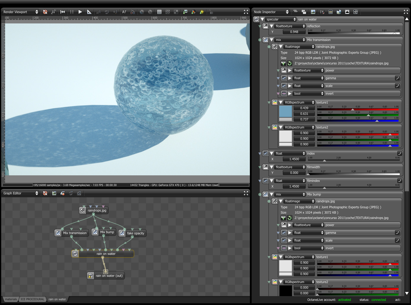

Rain on water
Also made for the contest, small improvements to have fake caustics and light passing thru, it has to be used as a plane above the ground, you can make puddles in the mesh.
