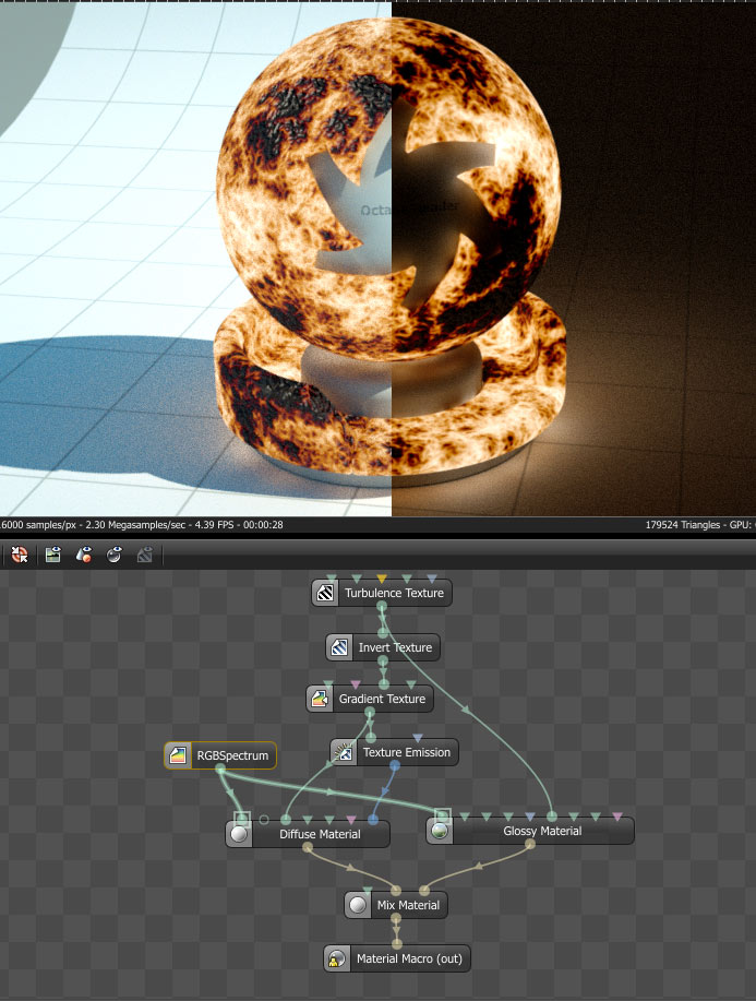

a simple light emitting lava shader, fully procedural, now found in the Misc category.
Some text notes on the values that can be customized were added to the description.
