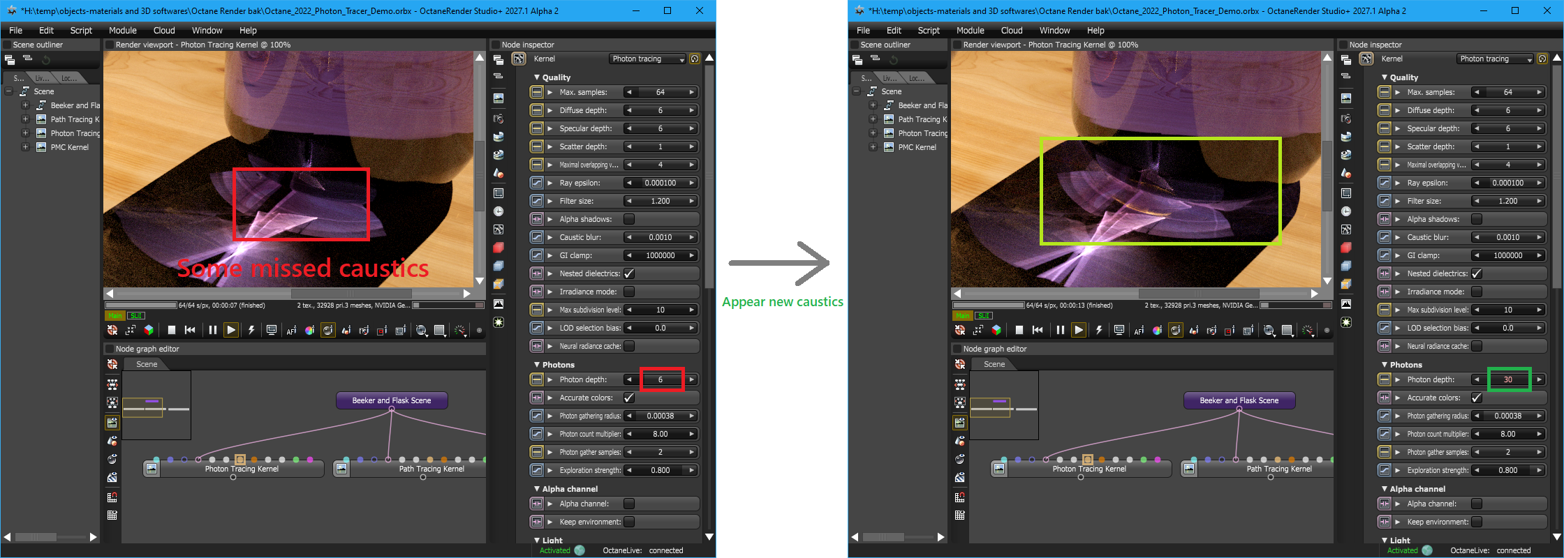

-To increase photon or diffuse depthes for add new caustics-:

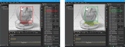

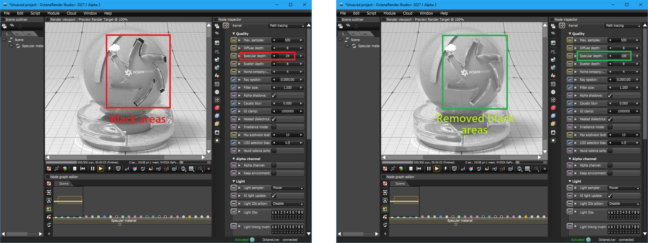

-To increase specular depthes for remove any black area-:
But IMPORTANT FIRST: To decrease "ray epsilon" from default value to ideal value for remove any black area. If this doesn't eliminate any black area, try to increase specular depthes.
