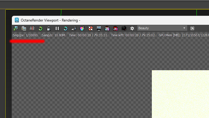

coilbook
Posts: 3133
Sometimes octane viewport gets stuck at 1 when using focus picker

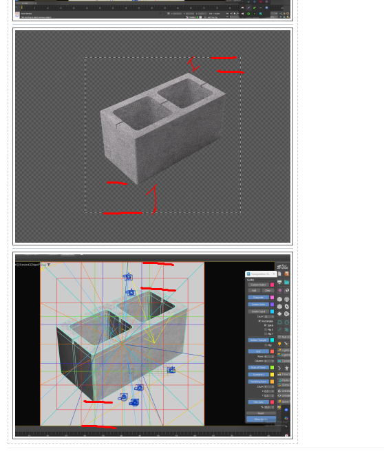

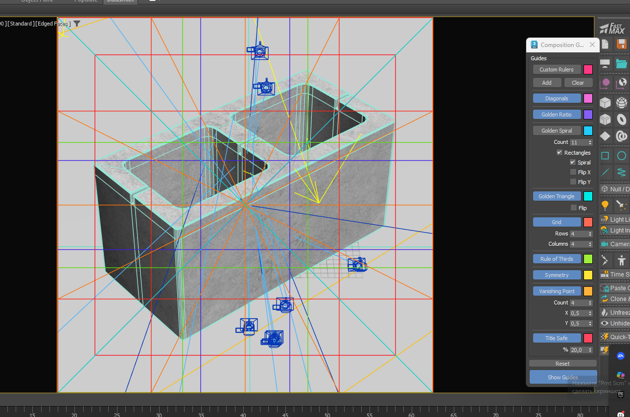

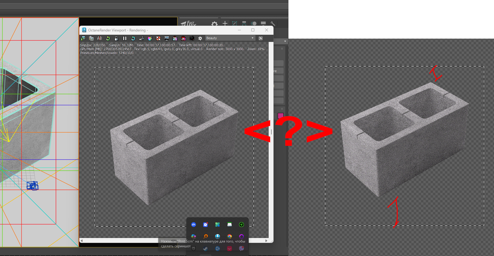

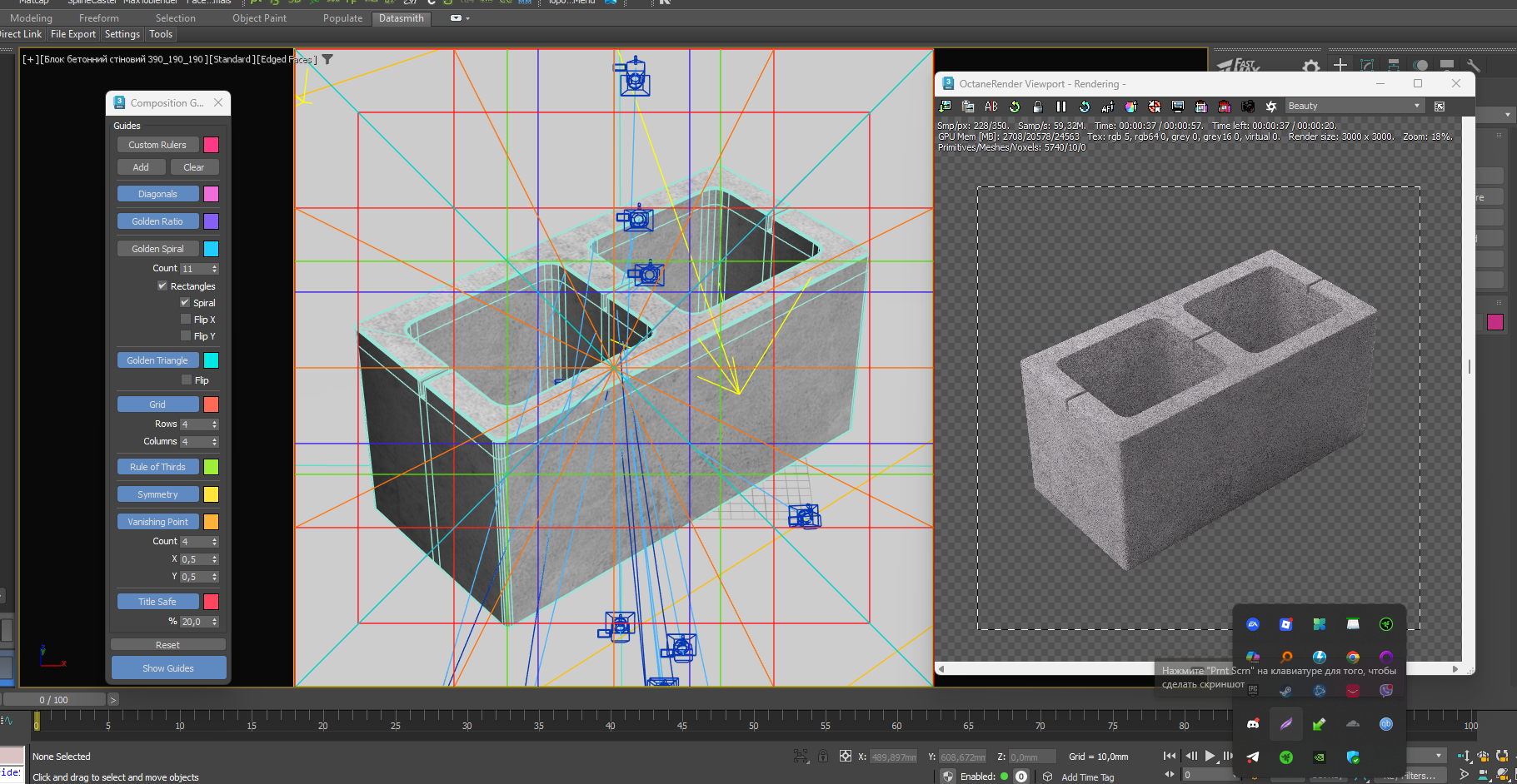

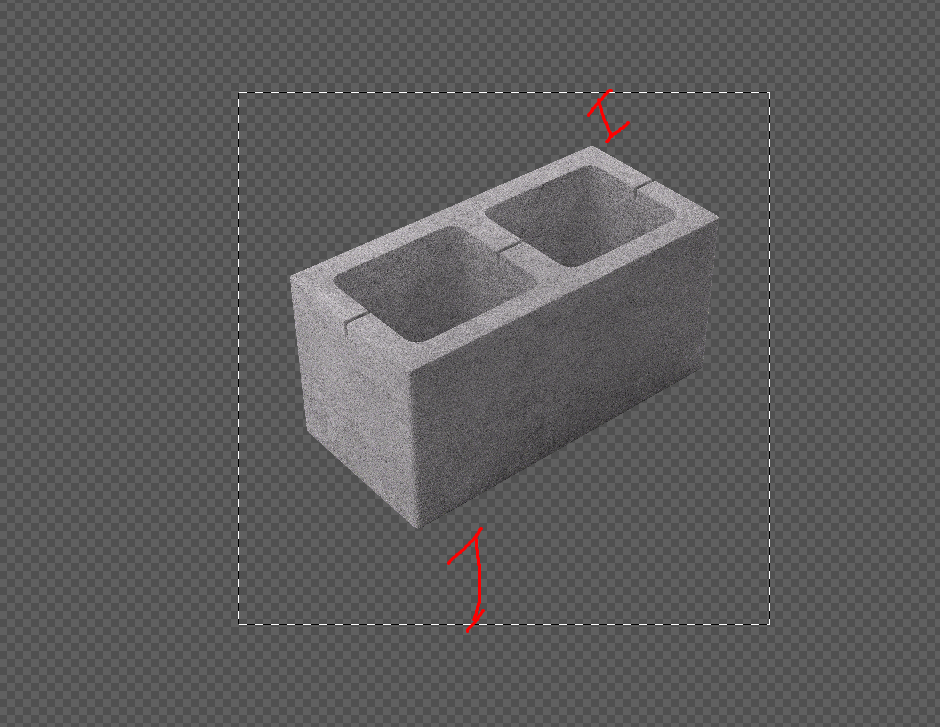

Elvissuperstar007
Posts: 2601
Location: Ukraine
The camera is glitchy
A regular physical camera
paride4331
Posts: 3937
Elvissuperstar007 wrote: Thu Apr 23, 2026 3:04 am The camera is glitchy
Hi Elvissuperstar007,
Could you clarify what changed between the first screenshot (which looks correct) and the one you’ve marked as incorrect?
Regards
Paride
Elvissuperstar007
Posts: 2601
Location: Ukraine
I’m setting up a camera composition and centering the model in 3ds Max, but in the Octane live (dynamic) preview the object appears much higher. If I adjust and center it in the live preview, then in the scene viewport it ends up lower.
There is no synchronization between the camera/object positions in the viewport and the live render — they seem to be in different coordinates.
