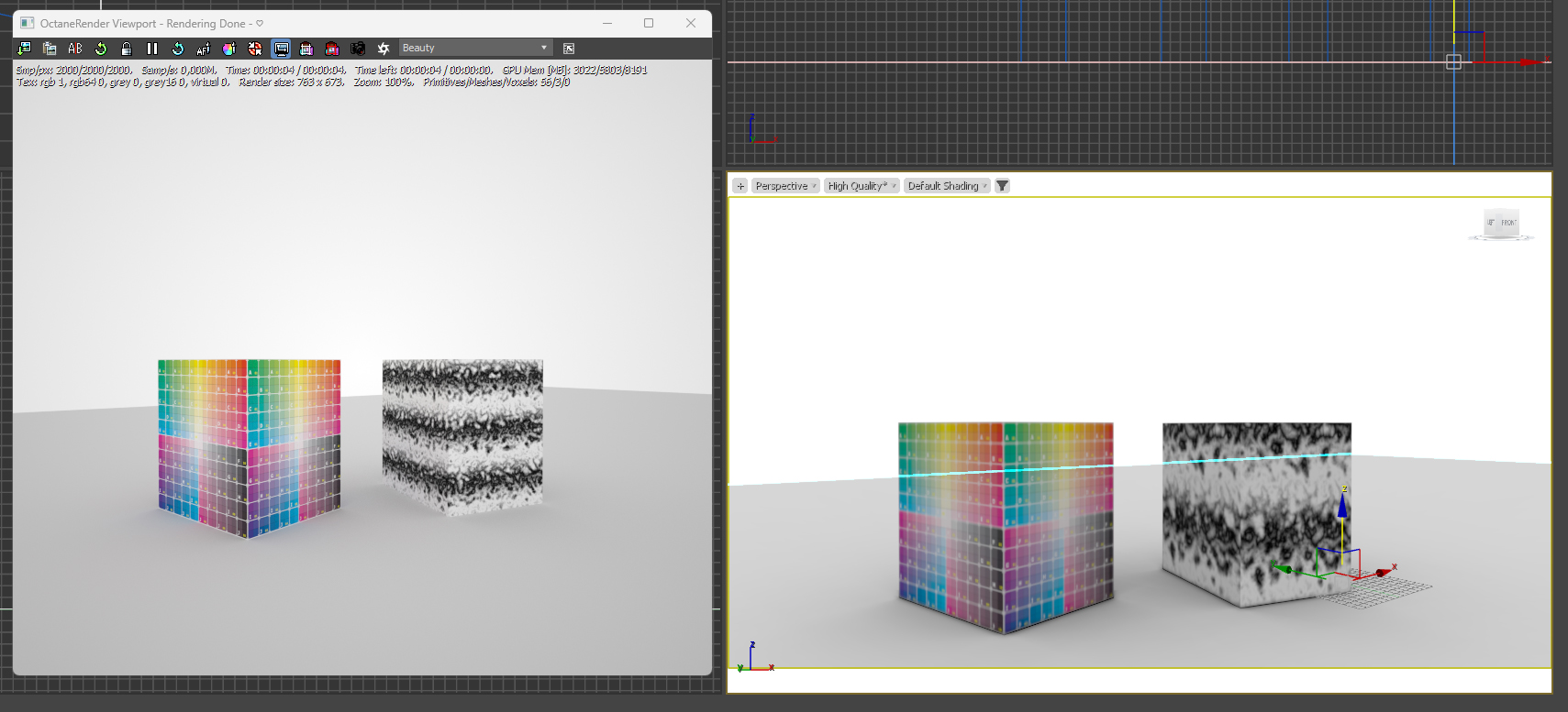

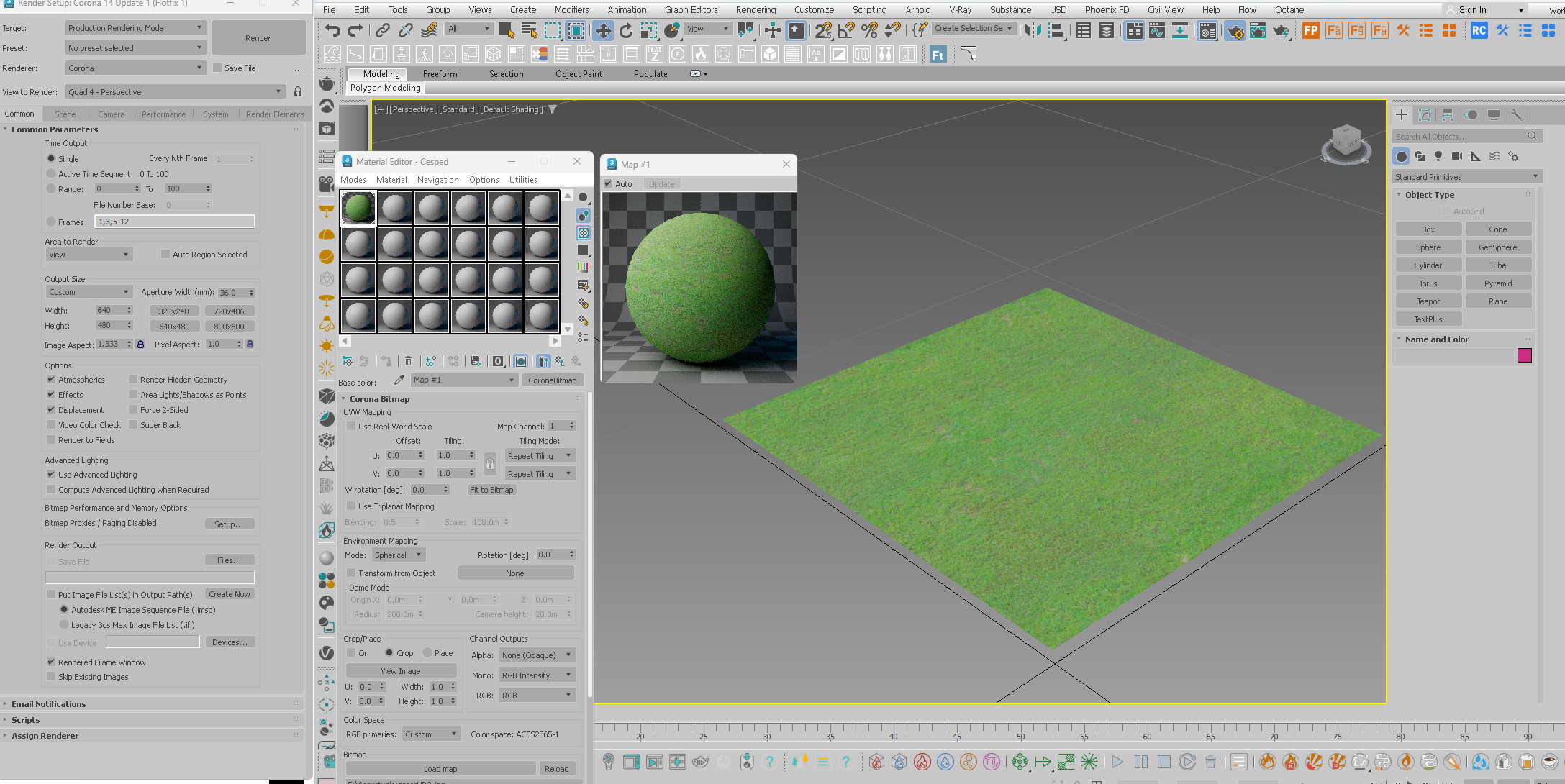

In Corona Renderer, there's no detail when assigning the texture in "Show Shaded Material in Viewport."
I believe the issue lies in the OctaneRender algorithm.
I'm using Windows 11 Pro for Workstations x64.
No appear the texture in the object

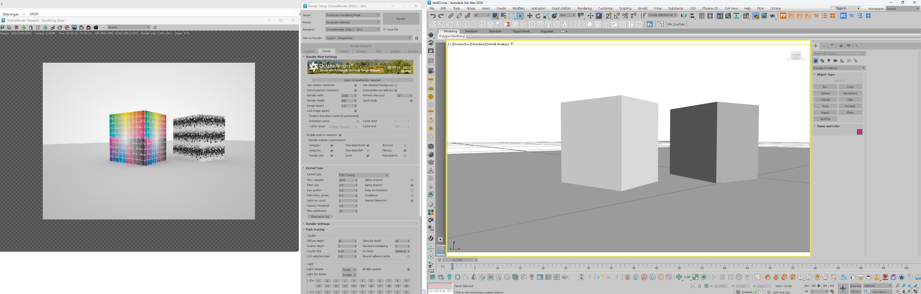

Hi parid4331, well, it's the same result; the textures aren't visible on the objects when they're applied.
I think it's either 3ds Max 2026 version 3.2 or the Nvidia A4000 driver.
Until the 3ds Max 2027 version is released, I'll install it and see if it causes the same error or if it's fixed.
Thank you for your patience in trying to resolve this issue.

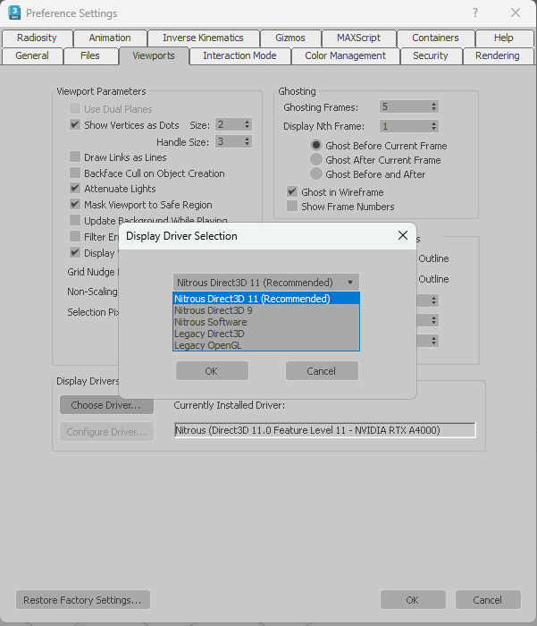

Try resetting the Nitrous viewport: go to Customize > Preferences > Viewports > Choose Driver > switch from Nitrous DX11 to DX12 (or vice versa), then restart 3ds Max.

Hello parid4331, thank you for response, but I been did this step of the restar Nitrous and nothing happen.

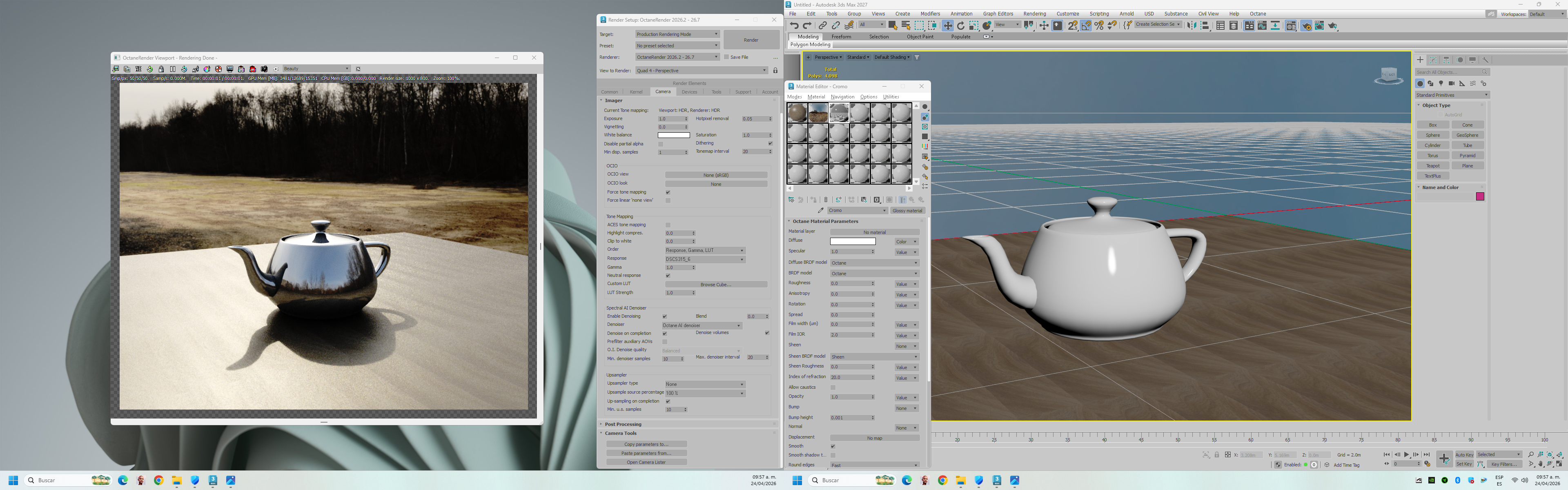

If possible, installing 3ds Max 2027 you can try setting up Octane for 3ds Max first, before installing any other render engines, to check whether the issue occurs.

It's work for right now in 3ds max 2027.
Just making several tests to be sure.
Thank you fotr you patience with me paride4331.
