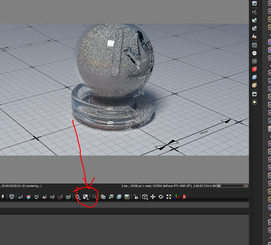

Real-time neural viewport
Octane 2027 features a new real-time neural rendering mode, built on Octane 2026’s NRC framework, which enables near noise-free interactive rendering without any compromises to Octane’s spectral path-tracing, even in complex lighting conditions, using a combination of OTOY's latest research and NVIDA's DLSS Ray Reconstruction.
This feature can be enabled and disabled using the thunderbolt button on the viewport components bar. It enables near noise-free interactive rendering in Octane with very low sample counts compared to traditional path-tracing, even in complex lighting conditions. The quality setting can be changed for the real-time denoiser under the imager node, allowing you to balance between quality and performance depending on your hardware.
Here you can see a preview of the new real-time mode in a variety of environments, featuring camera movement and object and light manipulation in real-time while keeping viewport interactivity.
Please be aware that we are still actively working on improving some quality and memory management aspects of the new real-time mode but do not hesitate sharing your feedback.

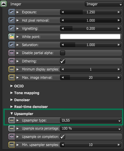

I can't find where the DLSS function is? I think this function needs to be put in a more obvious place. If I can't find where it is, then the average user definitely won't know about it.

Elvissuperstar007 wrote: Tue Mar 17, 2026 5:30 am I can't find where the DLSS function is? I think this function needs to be put in a more obvious place. If I can't find where it is, then the average user definitely won't know about it.
Hi.
It can be found in the Upsampler section of the Imager node, just like previously existing up-sampling methods.
DLSS upsampler in imager node

Thank you for the tip
Will the ability to replace DLSS and FSR with newer, more advanced versions via DLSS Swapper be implemented? Currently, it does not detect Octane in the list. This is important, as upscaler versions are constantly improving.

Explain how DLSS works. From my understanding, I should render at a lower resolution and then upscale it to 2K or 4K, while keeping the image sharp and not blurry, especially if we are talking about DLSS 4.5.
Right now, I don’t fully understand it. I tried using DLSS, but rendering actually became slower than without it.
I need a clear explanation or a video showing how to use it properly.
noldo
Posts: 94
Joined: Wed May 25, 2011 7:07 pm
I'd also like an explanation of how upscaling works. I use Octane standalone, but when I enable it at 50% resolution, I get the same resolution image with twice the pixel size.
