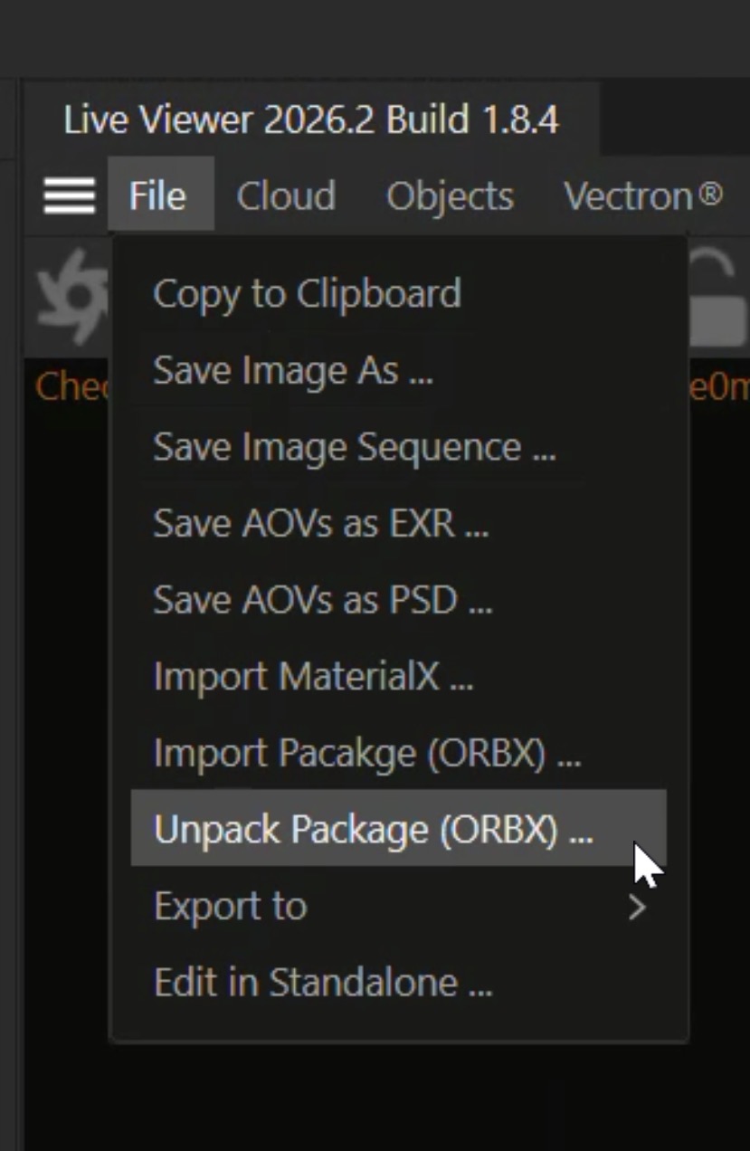

Try to export from R20 to Standalone, then open the .orbx scene with Standalone 2026.2, and check that all materials are converted correctly, then save the orbx scene.
You can right-click on a material and choose Render.
Then, back in C4D, you can go to Live View menu File and use the "Unpack Package (ORBX)" command, to import all materials at once:
ciao,
Beppe

Everything works fine up to loading and rendering/checking the materials in 2026.2 standalone, and also saving everything as ORBX-scene.
It is possible to reload them into standalone. The biggest material-scene (360 MB) takes about 10 sec with 50 textures, wich are the 360 MB.
But it all stops at C4D importing/unpacking the ORBX files. Either C4D crashes or I stop it after about 20 to 40 minutes. It is a pitty that there is also no progress bar for the process (in case i am not blind ..).
Importing will take similar time, but it seem to be impossible to convert the import into C4D-objects or - here - materials.
Is there maybe another way?
Thanks alot!
Edit, btw.: OctaneC4D can load, but standalone can't save MaterialX, right? And standalone can save, but plugin can't load OCS files, right?
