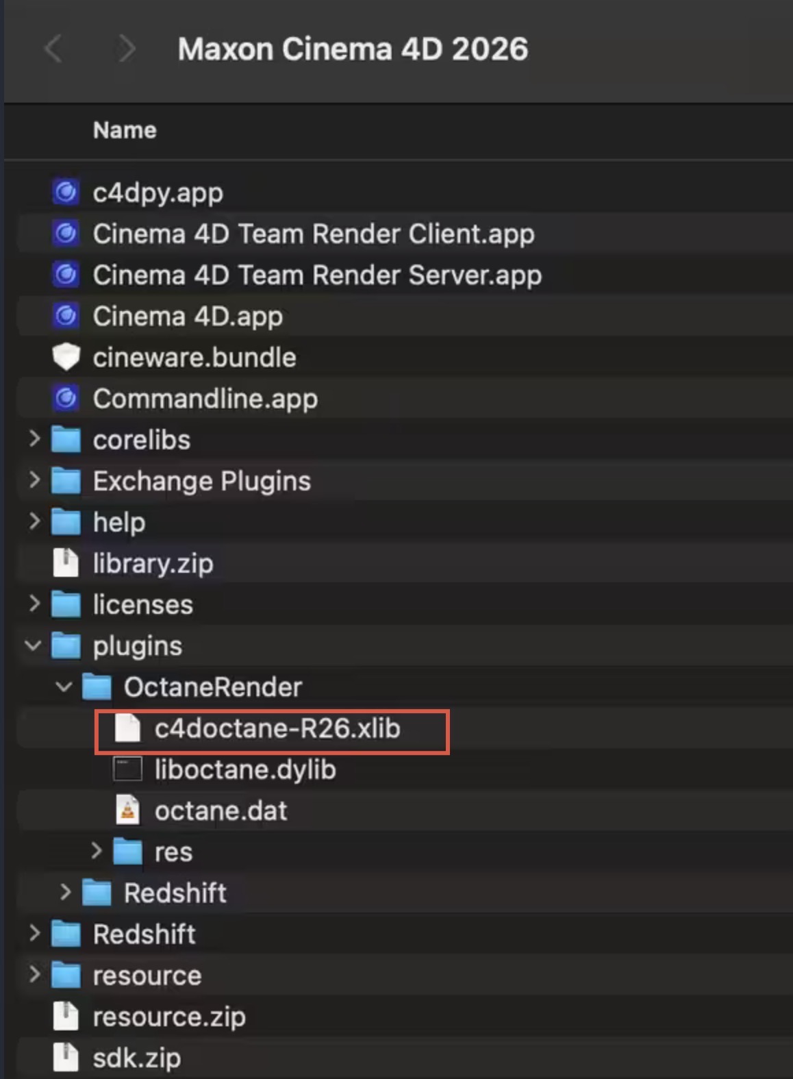

Thanks for responding. I'm running Sequoia (15.6.1) and the plugins are installed in the correct location, as far as I'm aware (without duplicates for the wrong version of C4D). Here's a screen grab of the directory showing them in place:
Image(Link)
But when C4D starts up, there's no sign of Octane. Is there any way to show a list of active plugins in C4D? The preferences pane only shows the directories added

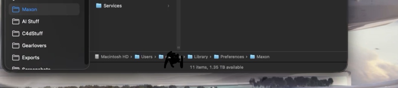

Pretty sure the plugin needs to go in the other “plugin directory” not the C4d one. - should be over in the directory below “see attached”

Posts: 10600
The installation path is the correct and preferred one.
If you install it in Preferences path it is user dependent.
The issue is that you have kept the wrong .xlib file for C4D R26, instead of 2026:

bepeg4d wrote: Mon Oct 13, 2025 7:19 am The installation path is the correct and preferred one.
ciao,
Beppe
Ah brilliant! Thank you Beppe. I should have looked more closely :)
