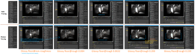

Hello. :)
New rendered images:
This is easier and better understand about the variable caustics. :)
--> Download - ORBX project <--: Don't forget to change kernel to Photon Tracing (PHT) - check new image above about PHT settings. ;)
Happy Rendering and Best regards. ;)

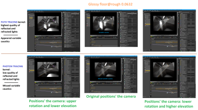

Hello. :)
--When the camera is moving--:
-On Photon Tracing, caustics aren't changing due to MISSED "variable" caustics;
-On Path Tracing, caustics are changing despite fixed light source.
Happy Rendering and best regards! :mrgreen: ;)
