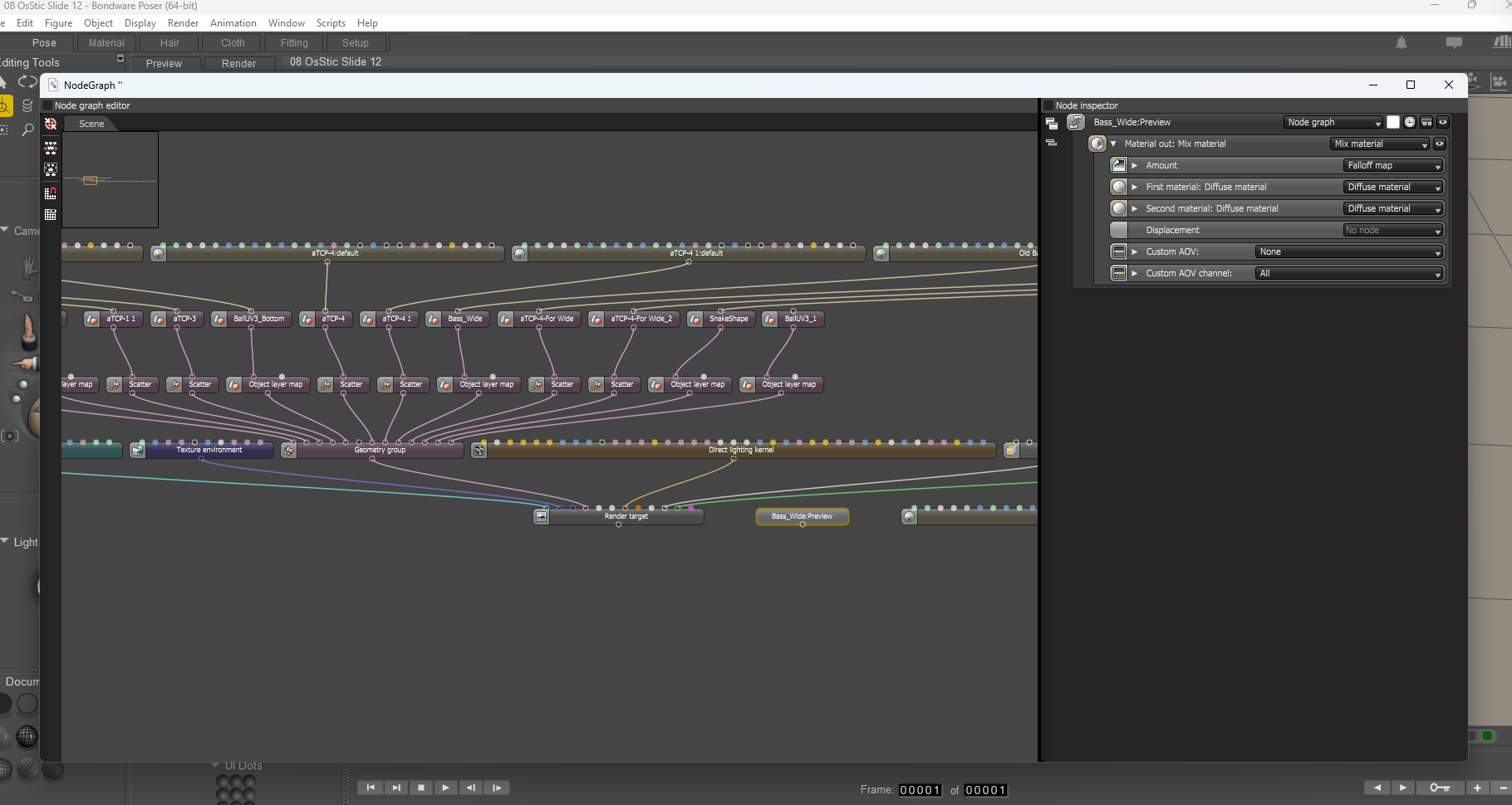

Hey Paul,face_off wrote: Sun Aug 28, 2022 11:02 pmThis is not really possible - the idea of displaying the NodeGraph window is so that you can see how the plugin has transferred the Poser scene to Octane. It is not intended for updating settings - sorry.Okay, what about applying the node graph feature to the render Target settings then.
Paul
I know you said this was impossible a few years ago. But it seemed like the impossible happened.
Has that changed?
Because I went into the node-grab editor for a material. And it opened up not only the material but the render target settings as well.
But I can see the render target in the node graph editor of the plug-in. See my screenshot.
And changing the settings in the note graph on the render target. Changed the settings in the Poser scene.
Seems like it was some kind of glitch. I can't seem to recreate it. But it did work.

It looks like there is a bug in the plugin nodegraph code where if you open the nodegraph a second time, it is referring to the first nodegraph, which may not exist anymore. This is something I need to fix - it is happening with some of my other plugins too.Seems like it was some kind of glitch. I can't seem to recreate it. But it did work.
Paul
