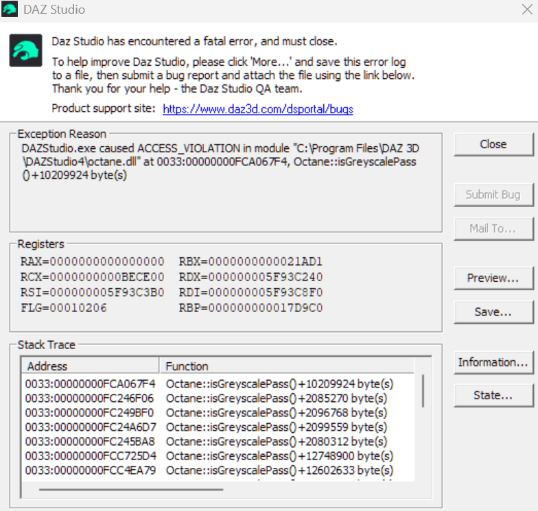

I just got this crash while using this new version of the plugin and while access violation crashes are rather common in Daz Studio, this is the first I've had that lists octane.dll in a long time (years?), as there was a concerted effort to report and fix them all a while back.
At the time I was panning the camera, which doesn't really seem related to the crash, so not sure that helps.
Is there anything else that should be provided next time i get a crash or is this enough?

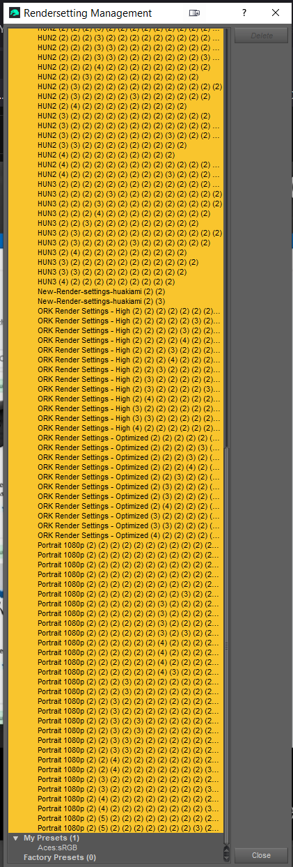

Delete Render settings does not work under rendersettings manegement the button is grayed out what ever i try one or all selected
