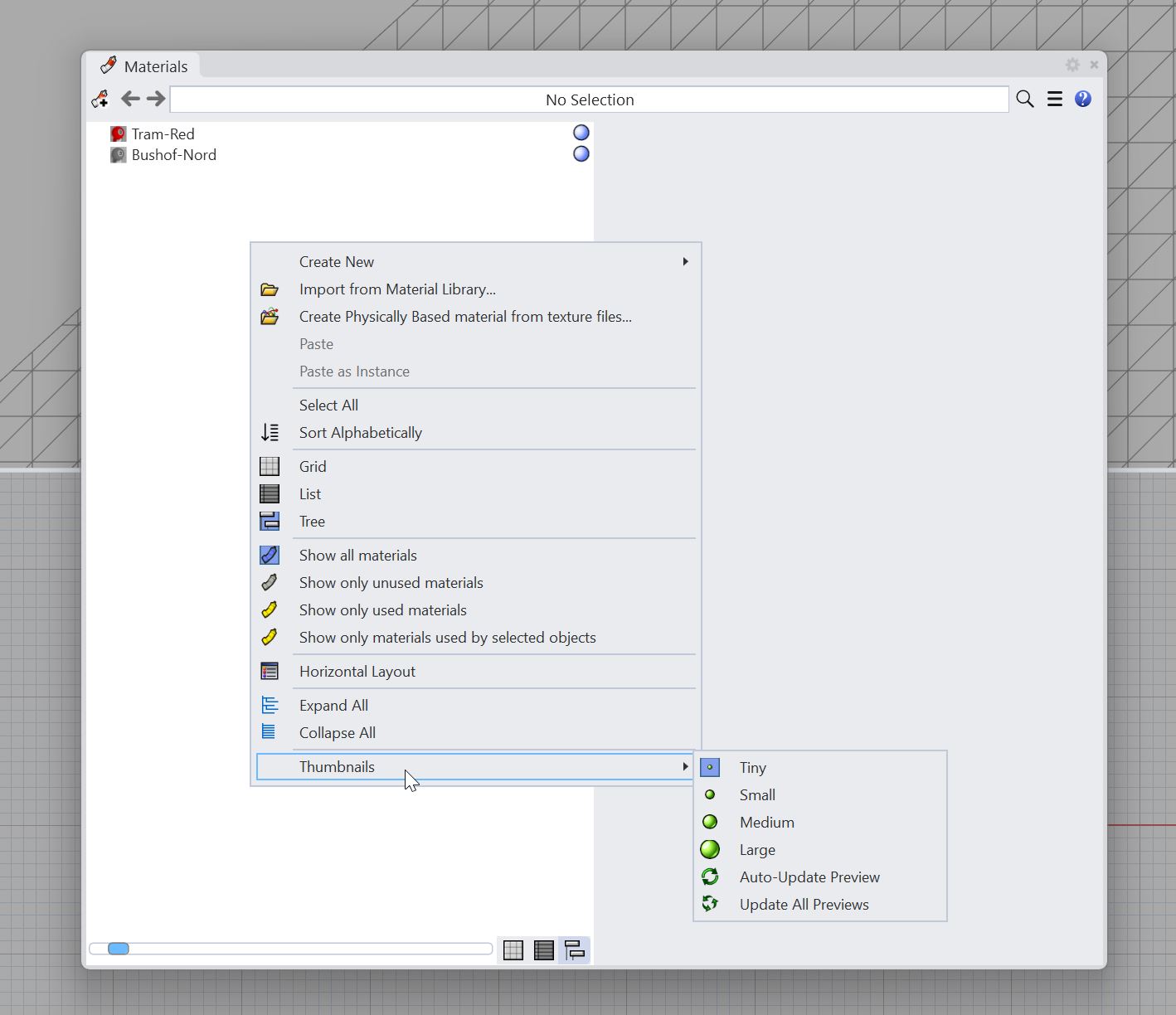

3.I have to say, that I also had the suspicion that the thumbnail generation might be the culprit, since they are painfully slow to update anyway, concerning the current render engine, I am not completely sure if I had it turned to octane during the crashes I think I remember having it switched to rhino renderer after installing the old octane version...
Is there maybe an option to turn of thumbnail generation all together? Right now the only option is to have tiny thumbnails, which is what I use, personally I do not need a thumbnail anyway, because I tinker with the materials while watching the result in the octane viewport.
