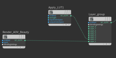

- 5. So if you're working in ACES but want to preview luts the way to do that is with the custom output AOVs. If you dive into the rendertarget it will take you to the output AOV section, with one example AOV setup already. You can plug in an "Apply LUT" node into the layer group and add your lut there.
Sorry for the inconvenience. Hopefully we can get most of these things resolved here soon!
