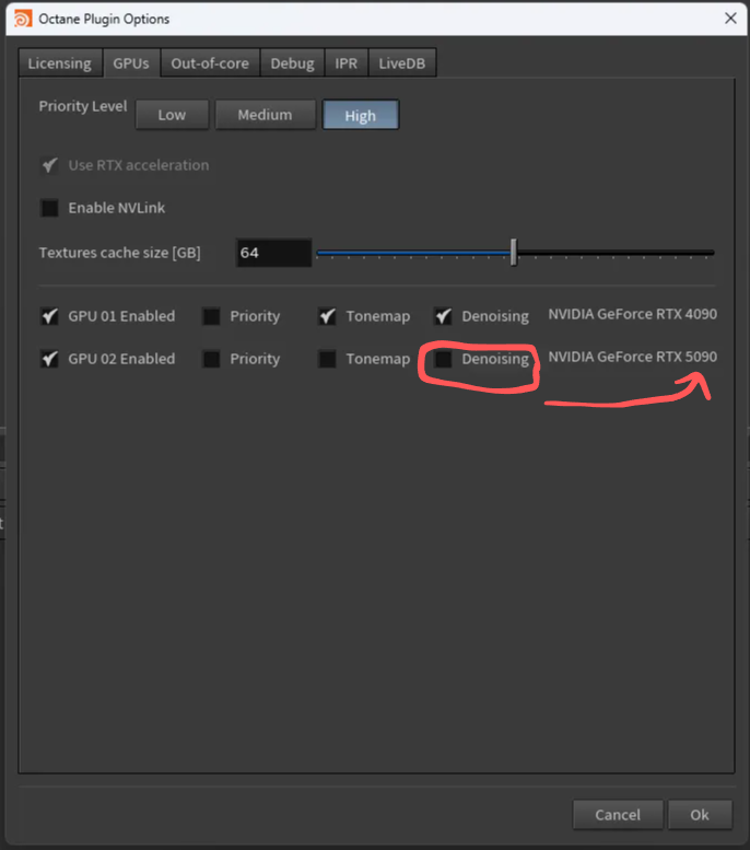

only after reinstalling this build again I notice the tick box of the devil.
Haha sorry what do you mean with the tickbox of the devil? The GPU one?
https://app.milanote.com/media/p/images ... /image.png
This tick box. if it's off on 5090, things are normal. Or disable the denoising from the imager altogether.

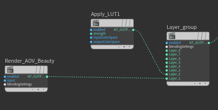

5) Unless I'm missing something, there's doesn't seem to be an intuitive way to work with LUTS when also working in ACES. Ideally, there'd be a way to apply a LUT transformation after the ACES conversion to sRGB display.

- 5. So if you're working in ACES but want to preview luts the way to do that is with the custom output AOVs. If you dive into the rendertarget it will take you to the output AOV section, with one example AOV setup already. You can plug in an "Apply LUT" node into the layer group and add your lut there.

Is swopped it between 4090 and 5090 , and 5090 started working with octane no crash at all...
however same cable on 4090 works fine ...
i guess 50 cards just needs extra cares ,,
dom_otoy
Posts: 141
Joined: Mon Mar 17, 2025 9:33 pm
rifat wrote: Sat May 03, 2025 12:38 pm
dom_otoy wrote: Wed Apr 23, 2025 4:25 pm
rifat wrote: Wed Apr 23, 2025 2:19 am
TBH I don't know what is wrong anymore, so far I find 572.83 is most stable. latest driver crashes none stop even with denoiser off on 5090.
I've tried only with 4090 and only 5090 before, also tried both plugged and disabled GPUS in octane setting as well.
it;s defo 5090 issue with octane. Dont use latest driver!
Feel free to try this file https://media.milanote.com/p/files/1U7p ... 0test.orbx
One thing I notice when I use octane is rendering windows don't pick up info for the second GPU.
I also tested system with RS and blender don't seem to have problem of shutting down.
Thank you for providing this info!
So with the 572.83 driver, do you still get crashes if denoising is on on both GPUs?
Also did you physically unplug the 4090 and you still got crashes on the 5090 with denoising with that driver?
Sorry guys it wasn't octane or the driver, I was a faulty cable .....
