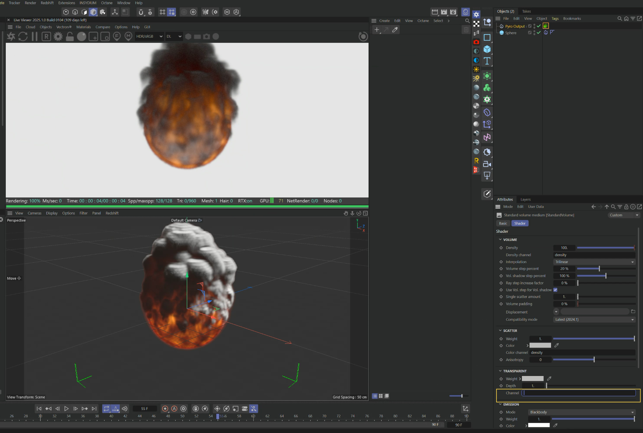

Delizade wrote: Sat May 03, 2025 5:44 pm After using Octane for two months over the course of a year, almost every critical move has ended in a crash or bug in this period.
Today, we needed pyro, so we added a sphere and applied an Octane tag to the pyro output after activating the Live Viewer, plugin crashed.
I don’t know what’s going on, but due to issues caused by Octane throughout this production process, I’ve lost a total of 5–6 full working days. We can also add today’s final two-hour struggle with pyro issue to that.
The pyro issue has been fixed and the fix will be part of next build comming early next week.
On the general stability issues. I have taken over this project for a couple of months now and a lot of issues have been fixed - sadly a few new ones have also been introduced like the pyro crash.
My goals for this project is not just to fix the issues however, but also to refactor the code in such a way that new bugs and crashes become much less frequent.
Additionally we are close to finishing our new automated testing system which should detect issues early on.
I am confident that within the next couple of months the Octane plugin will be much more stable, consistent and pleasant to use for users - while simultaniously much easier for the developers to maintain and expand.
