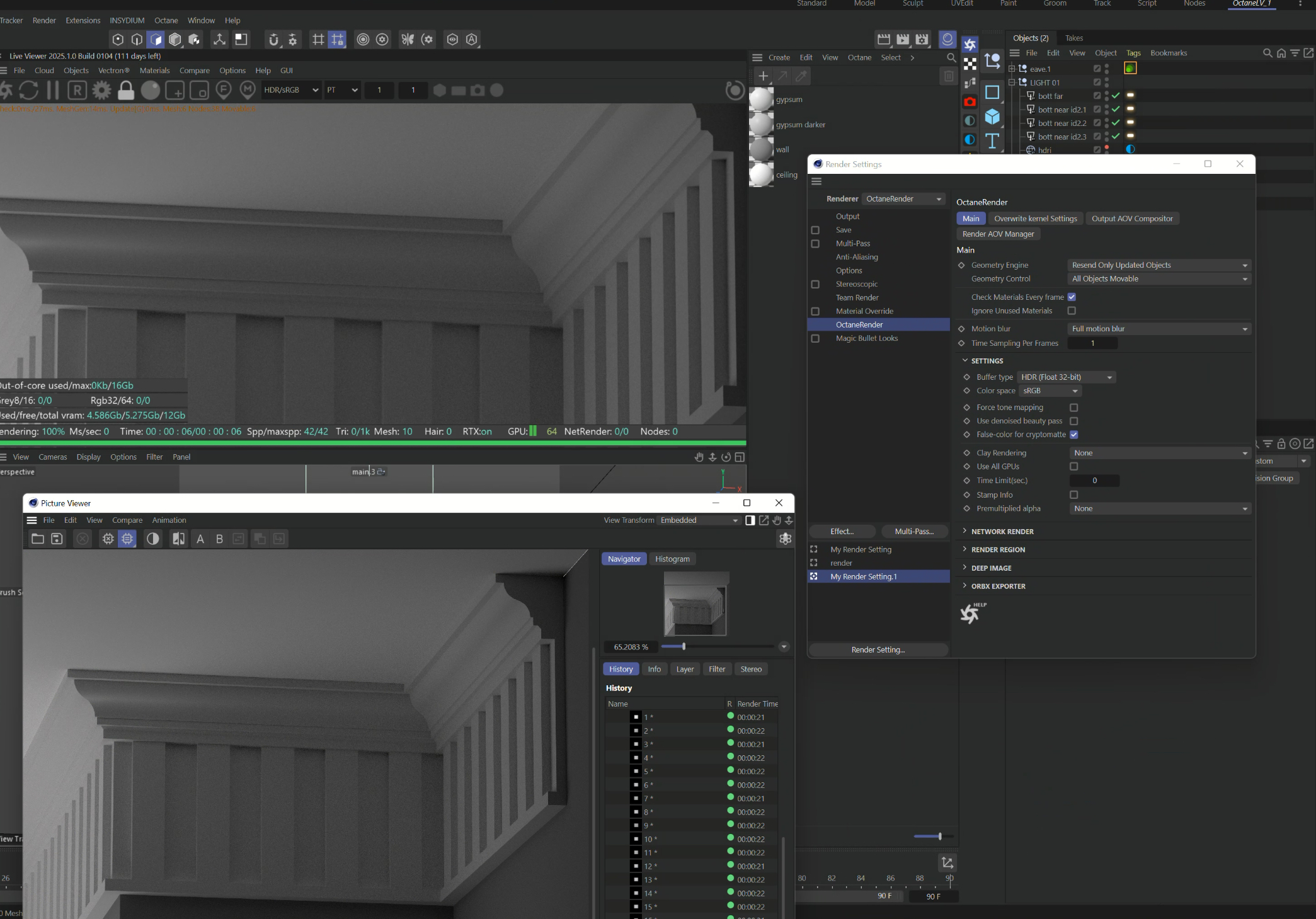

desire wrote: Thu Apr 24, 2025 11:43 pm
bepeg4d wrote: Wed Apr 23, 2025 8:38 am
Thanks for sharing the scene.
Light Masking is working as expected, but there is an issue with Live View update, so please go to "room_02" Octane Object Tag, Main tab, and enable the "Force update" option:
ciao,
Beppe
Hello, thank you for your answer!
Did the same as your instruction with no effect. Still get a wierd result to PV while "as expected" work of light masking at LV. Please see screenshot.
And you say nothing for a second question, unfortunately.
Here it is "a few versions ago the ability to add alpha channel to a beauty pass while saving PSD through Render AOV manager is gone. Why so? Could you fix it please?"
Thank you.
if you create a new Render Setting from scratch, everything works as expected:
ciao,
Beppe

bepeg4d wrote: Wed Apr 30, 2025 9:09 am Hi,
ciao,
Beppe
Hello!
Can't say it was obvious))) but I got it, thanks for the reply!
