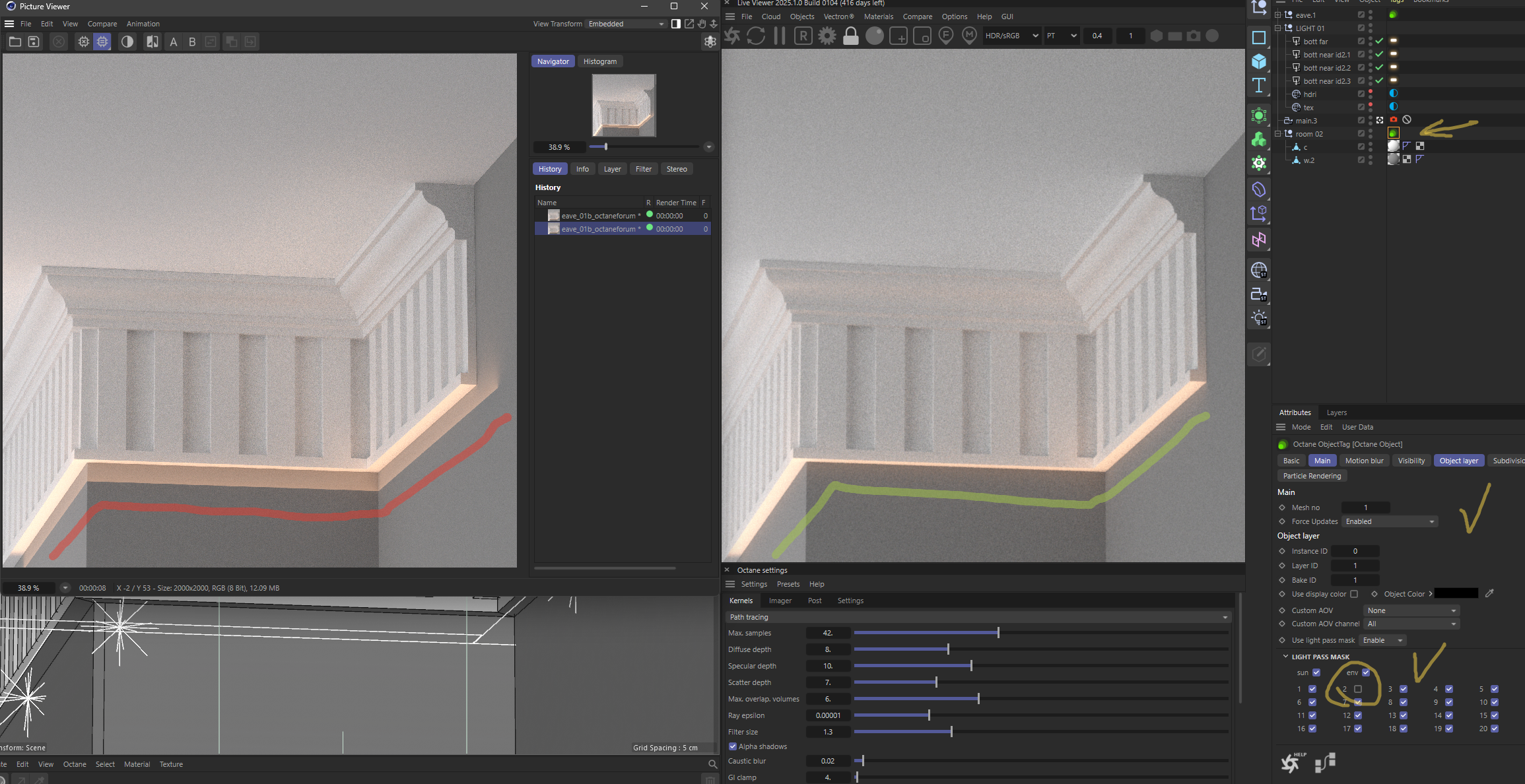

bepeg4d wrote: Fri Apr 18, 2025 8:31 am @desire:
sorry, I cannot reproduce your issue here, do you mind to share a scene?
ciao,
Beppe
Of course, here it is
Thank you
eave_01b_octaneforum.zip
(446.39 KiB) Downloaded 55 times

desire wrote: Tue Apr 22, 2025 11:11 pm
ciao,
Beppe
Thank you
Thanks for sharing the scene.
Light Masking is working as expected, but there is an issue with Live View update, so please go to "room_02" Octane Object Tag, Main tab, and enable the "Force update" option:

bepeg4d wrote: Wed Apr 23, 2025 8:38 am
ciao,
Beppe
Hello, thank you for your answer!
Did the same as your instruction with no effect. Still get a wierd result to PV while "as expected" work of light masking at LV. Please see screenshot.
And you say nothing for a second question, unfortunately.
Here it is "a few versions ago the ability to add alpha channel to a beauty pass while saving PSD through Render AOV manager is gone. Why so? Could you fix it please?"
Thank you.
