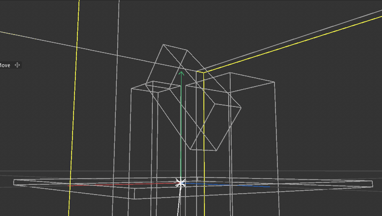

Hello,
I don't know if I'm using it correctly, but there is a bug/strange behavior with the rest tag as you can see in this video:
When I move an object inside a vdb mesher, the mesh disappear
Cinema_4D_4hf2Q8Ci1s.mp4
(8.71 MiB) Downloaded 290 times
Tim_Twisted
Posts: 53
Joined: Mon Apr 23, 2018 1:31 pm
Thanks Chris, looking forward to using the new Real Lenses. Are there also plans to further expand the lens flare post options since the lenses got this much attention?
DinoMuhic
Posts: 225
Joined: Wed Mar 25, 2015 10:24 pm
FxDesign wrote: Thu Apr 10, 2025 7:57 am Hello,
Thanks for the video.
Can you reproduce this with a baked/cached volume builder? Or even better with a baked-out alembic?
The rest position tag only stores vertex color data into itself when you activate it, which should not be enough to let the mesh vanish, so my feeling is there is a deeper issue here.
FxDesign
Posts: 110
Joined: Wed Apr 24, 2013 10:47 am
it's working better when cached, but after the last keyframe of a moving object, the mesh disappear again

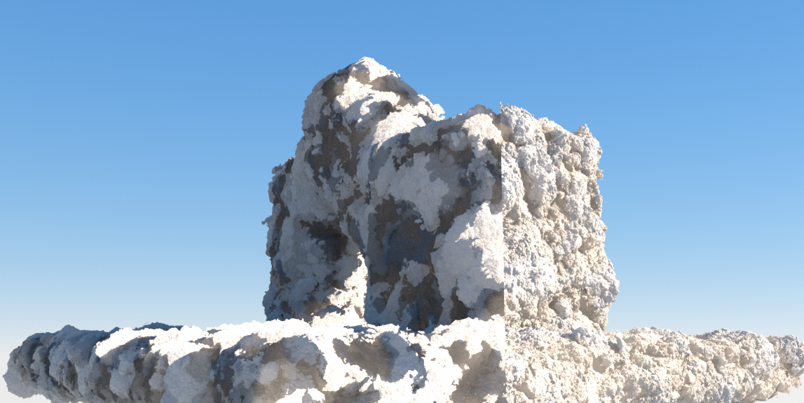

Hi and thanks for this incredible update !
I have a major problem with vectron displacement though... As I move the camera, I can see the vectron bounding box behind it and the displacement is clearly lackind details overall (except on some sections). Changing the bounding box size doesn't help...
Am I doing anything wrong ? I have attached my scene to this post as well as a video showing the issue.
Untitled video.mp4
(57.6 MiB) Downloaded 219 times
ChrisHekman
Posts: 1147
Joined: Wed Jan 18, 2017 3:09 pm
Martange wrote: Thu Apr 10, 2025 11:12 am Hi and thanks for this incredible update !
That is odd, i would not expect displacement to somehow to be view dependent. Could you send us your C4D scene?
Martange
Posts: 29
Joined: Thu Jan 21, 2016 4:21 pm
Of course, here it is
EDIT : I think it has to do with the "box" projection of the noise I use instead of the vectron bounding box...
VECTRON DISPLACE 2.zip
(105.85 KiB) Downloaded 123 times
