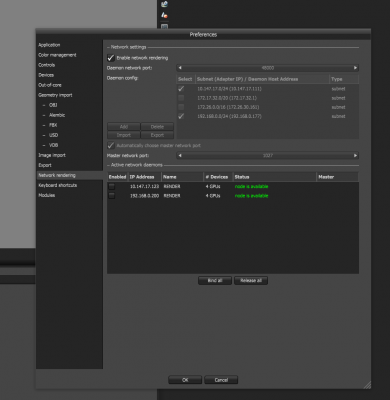

2024.1.2 - 15.12 has issue with network rendering
in stand-alone

Hi imanshirani,
Could you try manually setting the same master network port in the plugin as the standalone version?
Regards
Paride
Regards
Paride

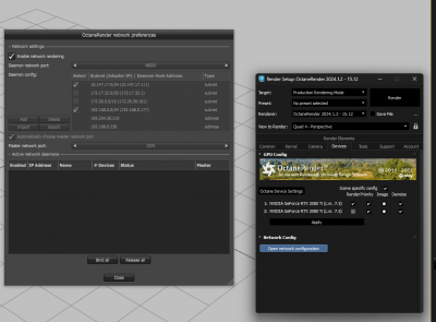

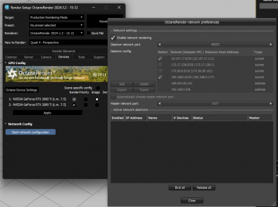

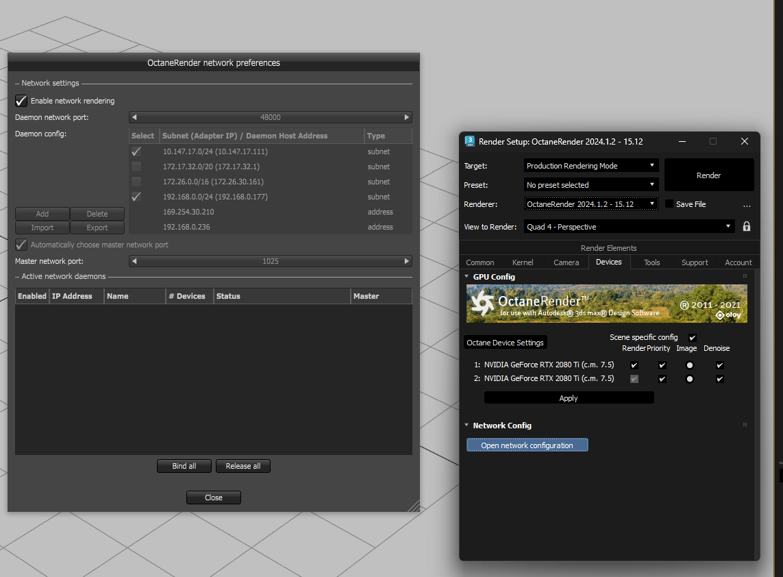

- imanshirani
- Posts: 25
- Joined: Tue May 24, 2016 3:29 pm
- Location: Remote
- Contact:
YES but not workingparide4331 wrote:Hi imanshirani,
Regards
Paride
