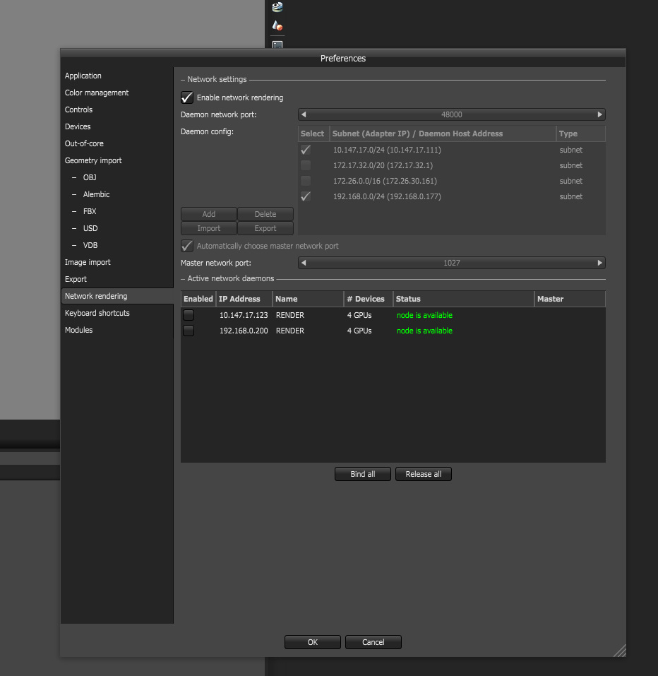

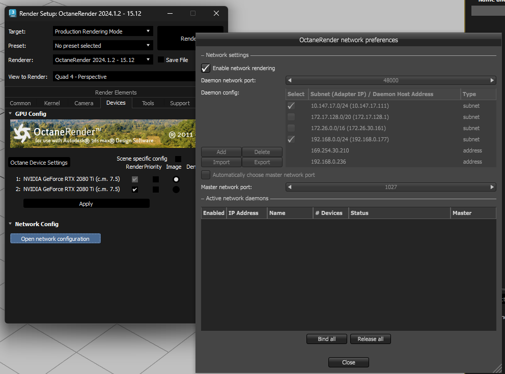

2024.1.2 - 15.12 has issue with network rendering
in stand-alone

imanshirani,
Have you installed the plugin and daemon with the same SDK version?

paride4331
Posts: 4005
Hi imanshirani,
Could you try manually setting the same master network port in the plugin as the standalone version?
Regards
Paride

paride4331 wrote:Hi imanshirani,
Regards
Paride
YES but not working
