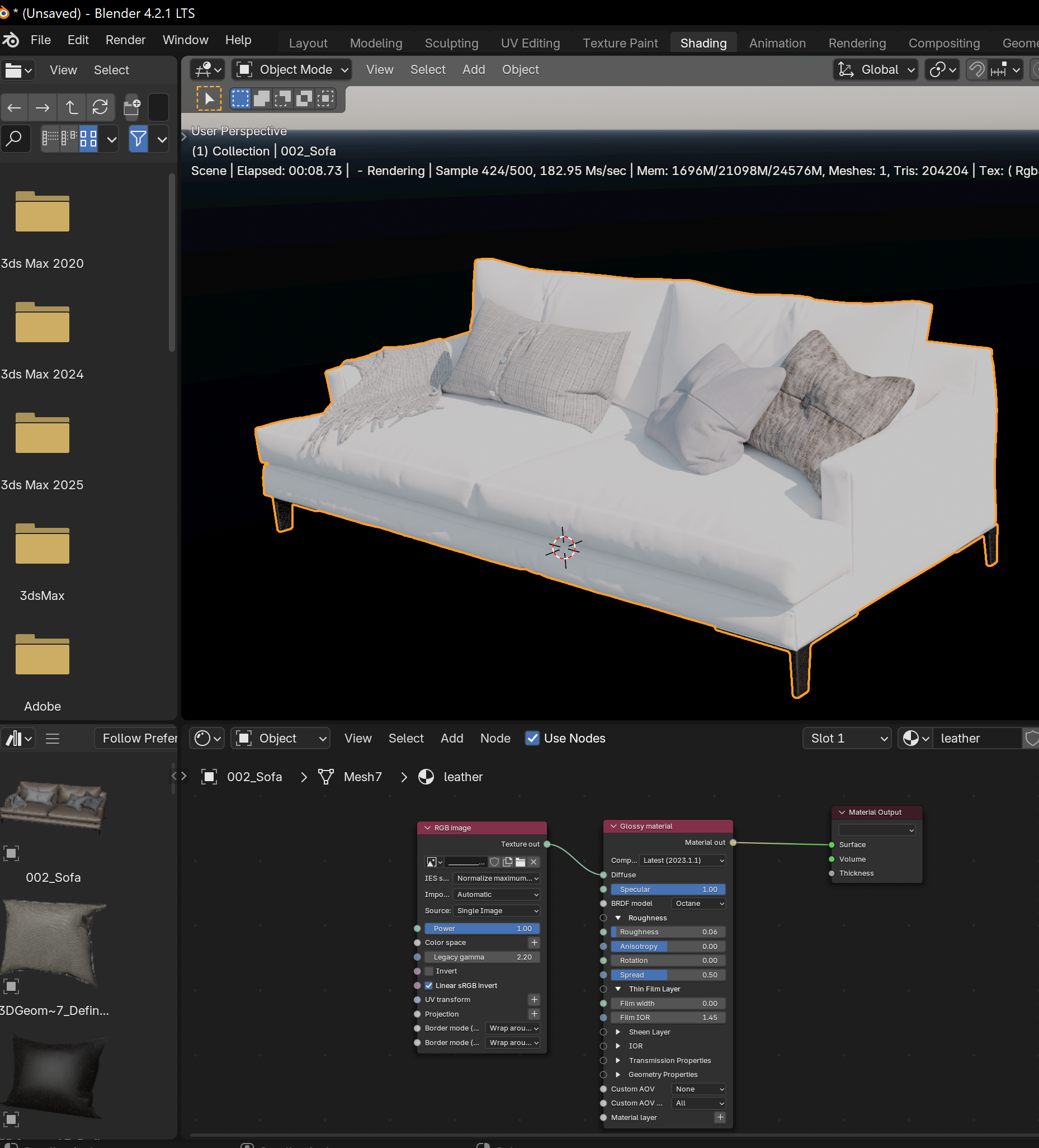

True as you said, in the 29.15 the issue is almost correct for most cases.
though I find myself in an embarrassed situation.
attached please find, when the old file is in the asset library, the issue remains...
if you open the problematic .blend file directly, it is fine, but if you insert the sofa from the asset library see the below image, the leather material lost...
