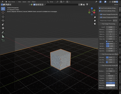

When I enable Octane Postprocess and trying to adjust Chromatic Aberration Intensity - an error occurs. It can be endless "Waiting for image...", or "ERROR! Check console for detailed error messages"
Terminal says:
Last Octane engine log entries:
compute device 0: copy size doesn't match destination image
I remember in simple scenes it worked but now it is not. Even on default cube. Maybe there's some settings i should check to eliminate this problem?

Just default settings. I'm enabling Octane Postprocess (Preview Mode) checkbox in viewport section and trying to add Chromatic Aberration intensity

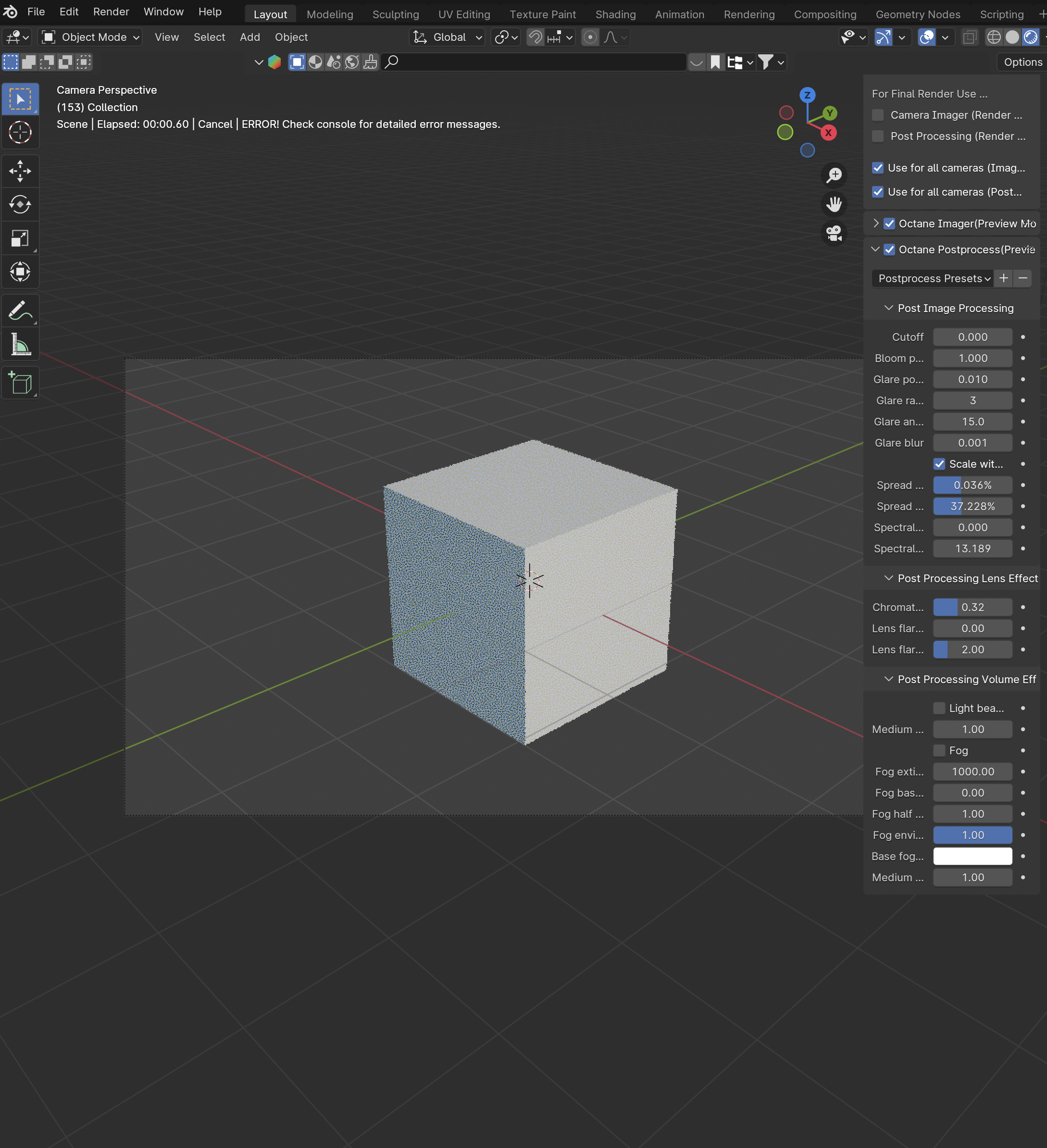

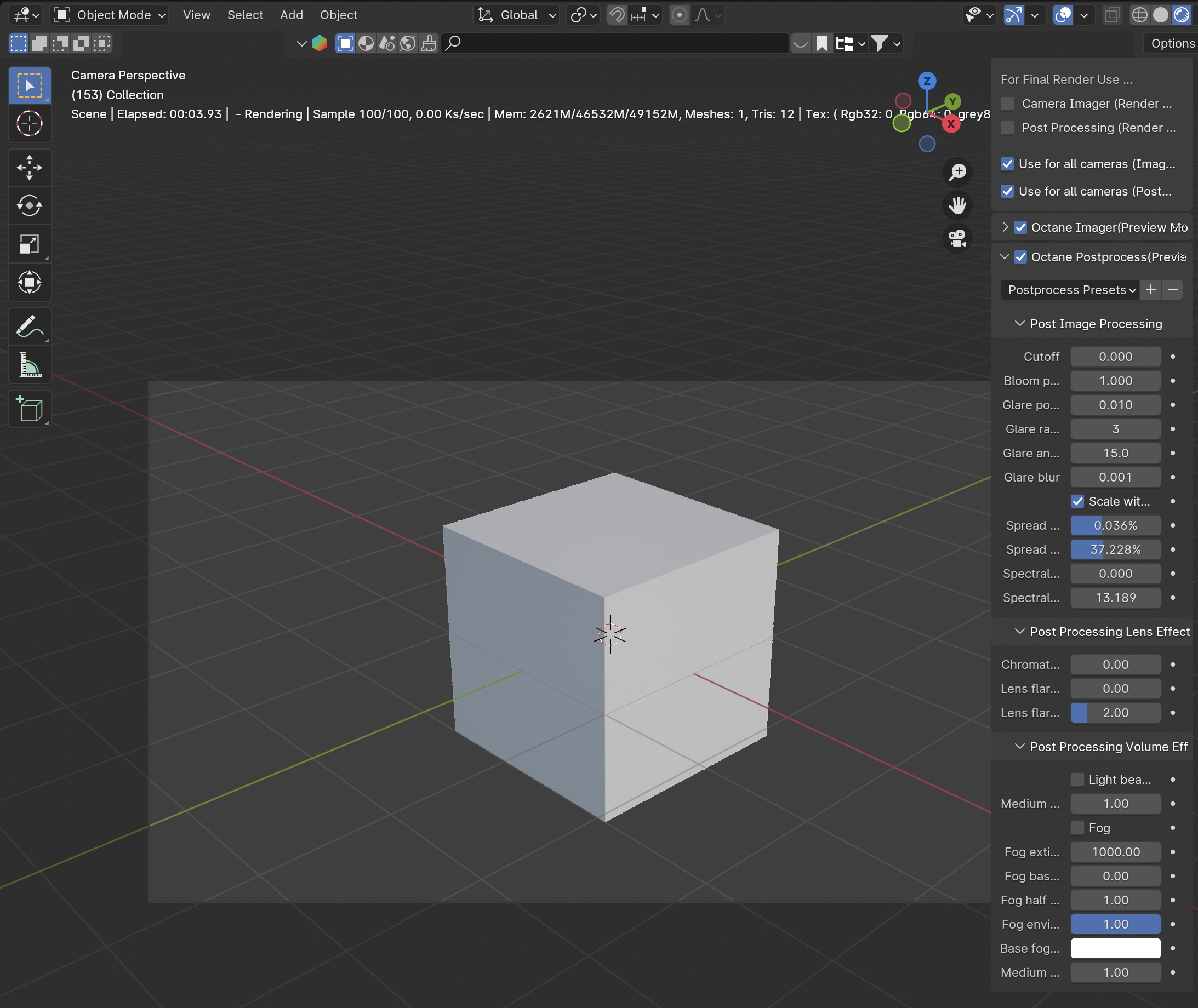

Here are 2 screenshorts - with and without Chromatic Aberrations

linograndiotoy
Posts: 1457
To have the perspective view Imager and PostProcess work, you need to enable the 2 checkboxes you can find on top of the Octane menu.
I notice you also have two additional ones that are unchecked. That may be the issue (those additional one are probably added by same addon you have installed - they're not part of the "default" Octane configuration).

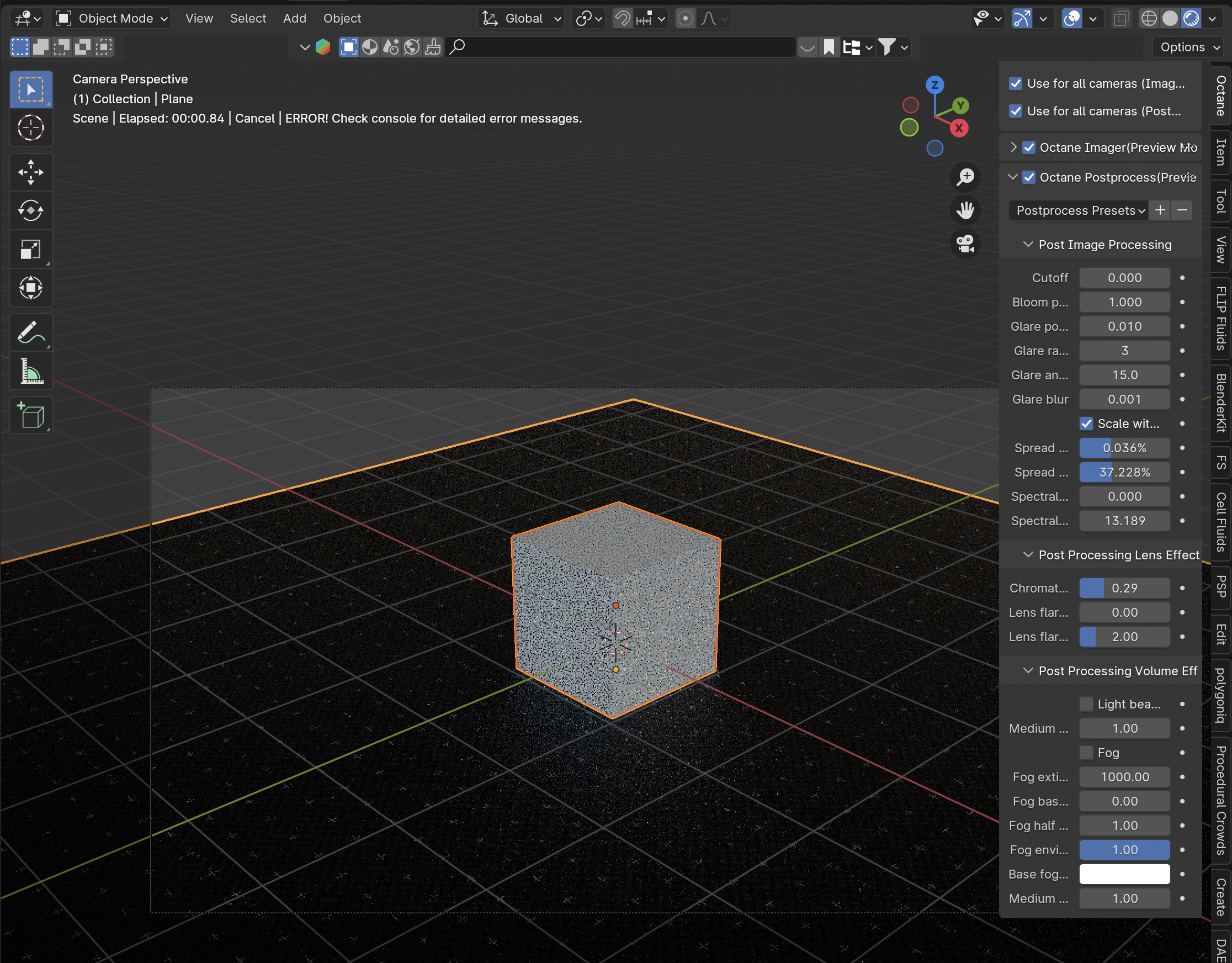

I've disabled addon (Octane Tools by Andreas Resch) and 2 checkboxes on top are checked, but still no luck =(
linograndiotoy
Posts: 1457
My feeling is this may be a Mac specific issue.
