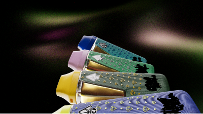

LAn example of how it should look (this is rendered in standalone, the only way to render it without the artifact in standlone is to render only a frame range of 10 or less

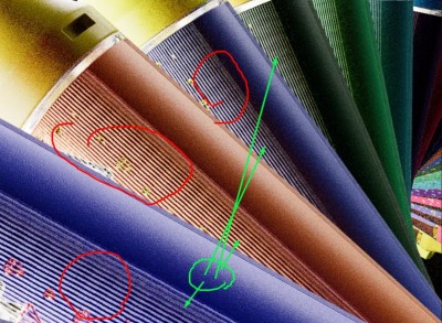

Example of artifact, the pattern of the artifact resembles the topology wireframe

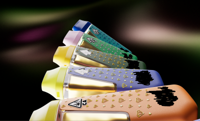

As shown in the image, the colored materials should resemble something similar to this micro-noise bump, only then there's also a pattern decal on top, but it's creating these streaks anywhere within the confines of the polygon selection that that material is assigned to.

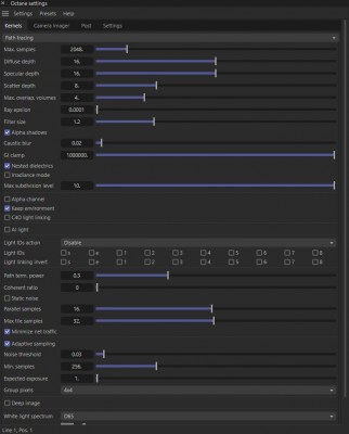

Could you share the Octane Kernel settings?
It would be complementary information, as well as versions of Standalone, C4D Plugin, OS and GPU Driver.

Kernel settings
Kernel settings

Cromo wrote:https://render.otoy.com/forum/download/file.php?id=93952&t=1
Judging by the provided screen capture of the kernel settings, the parameters haven't been setup appropriately according to the scene.
Some pointers ("red flags"):
* high (default) ray depth values (unnecessary for most cases)
* Caustic Blur default instead of maxed out (for actual caustics, Photon Tracing Kernel is the way to go)
* Keep Environment is rarely a necessity and likely not here, based on the provided renders and likelihood of the post-compositing absence
* Parallel Samples at default (VRAM headroom allows to push it to 32, the max)
* Adaptive Sampling is questionable, and hardly properly set without the Noise AOV to judge the sampling noise distribution
Render-time can be reduced as well as optimized sampling (fireflies and whatnot) by following this guide.

Thank you for addressing the pointers in my kernel, I corrected those, but didn't fix unfortunately though

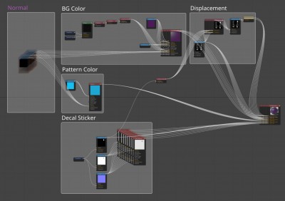

Node setup for 10 products each its own color variant on the same model, all nodes are connected cross-material, so 1 transform drives all the sticker decals for all color variation materials for easy changes, I don't know if this could be problematic potentially though

A common trouble-solving process is to disable step-by-step each elements and test out to potentially pin-point the culprit.
Here, the shading (by large groups as shown on the screen capture, such as disabling the displacement entirely)

Cromo wrote:Node setup for 10 products each its own color variant on the same model, all nodes are connected cross-material, so 1 transform drives all the sticker decals for all color variation materials for easy changes, I don't know if this could be problematic potentially though
I remember having issues with linking nodes across materials in C4D years ago until Ahmet set me straight: Because of the way C4D works internally, each Octane node technically "belongs" to a specific material and no other. Because of that, there can be odd glitches as a node tries to pass info to nodes other than what C4D considers its owner. As such, there's a bit of a behind the scenes juggling going on during render time that's a little different when rendering to Octane in the host app vs. after the scene has been exported/recompiled as an ORBX.
I wouldn't be surprised if your texture Displacement is especially sensitive to this issue.
If it turns out to be the multi-parented Transform node causing it, you might try linking attributes of multiple materials through an Xpresso node instead of trying to share one Octane node. I'm not sure how that gets translated into ORBX on export, but I've had luck with it.

Oh wow Frankmci, I think you nailed it on the head.
I did some tests turning off the displacement and it did remove the problem of the streaks.
However unfortunately ORBX export introduced some other glitches, which likely had to do with the cross-material connected nodes, this is something I did in an attempt to optimize as I thought more nodes or image texture consume more Vram.
