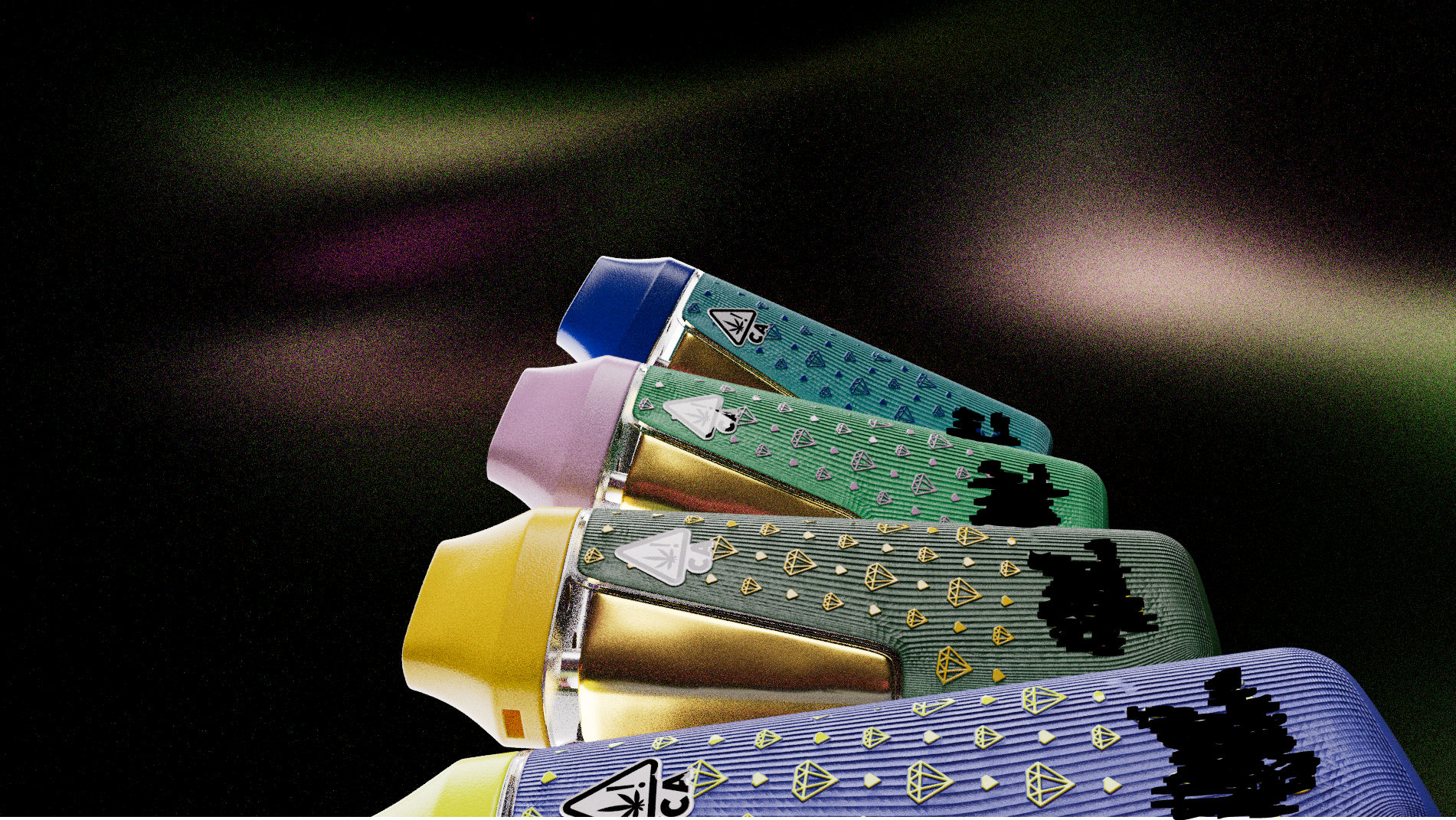

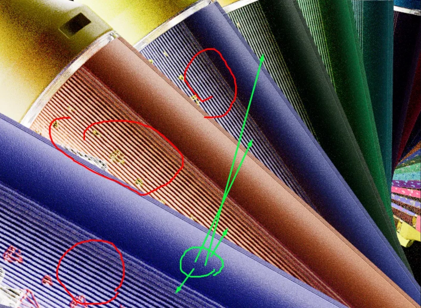

I am working on a project that I intend to render on the render network, however, some shots had weird artifacts, that only appeared after the ORBX export in standalone, but not in C4D LV or PV renders.
It's strange because earlier ORBX exports caused some ray epsilon-related issues that couldn't be completely resolved, as changing this parameter does influence it, but doesn't resolve no matter what value I try.
The similarity to that issue and this one is that they only show up in Octane Standalone after the ORBX export, but are gone if I were to render in C4D octane
The most interesting part is that exporting a single frame of the entire animation does not result in this artifact, and this works for up to a max of 10 frames, at 11 frames ORBX export to standalone the artifact would kick in, and rendering batches of 10 frames isn't ideal realistic for the length of the animation..

But according to the images of how it looks I'm gonna assume the issue looks associated with a certain material indeed, but I'm clueless about what I could have done wrong.
Would you mind elaborating as to how a material/node setup could cause this? as I have somewhat of an elaborate composite material set up, with quiet a few 8K textures, including normals and black and white maps/masks

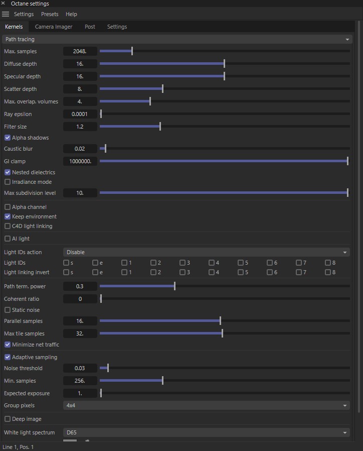

Thank you for addressing the pointers in my kernel, I corrected those, but didn't fix unfortunately though
partial alpha is disabled in the camera imager yes.

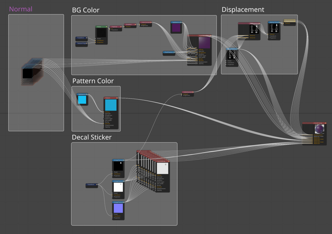

I remember having issues with linking nodes across materials in C4D years ago until Ahmet set me straight: Because of the way C4D works internally, each Octane node technically "belongs" to a specific material and no other. Because of that, there can be odd glitches as a node tries to pass info to nodes other than what C4D considers its owner. As such, there's a bit of a behind the scenes juggling going on during render time that's a little different when rendering to Octane in the host app vs. after the scene has been exported/recompiled as an ORBX.Cromo wrote:Node setup for 10 products each its own color variant on the same model, all nodes are connected cross-material, so 1 transform drives all the sticker decals for all color variation materials for easy changes, I don't know if this could be problematic potentially though
I wouldn't be surprised if your texture Displacement is especially sensitive to this issue.
If it turns out to be the multi-parented Transform node causing it, you might try linking attributes of multiple materials through an Xpresso node instead of trying to share one Octane node. I'm not sure how that gets translated into ORBX on export, but I've had luck with it.

I did some tests turning off the displacement and it did remove the problem of the streaks.
However unfortunately ORBX export introduced some other glitches, which likely had to do with the cross-material connected nodes, this is something I did in an attempt to optimize as I thought more nodes or image texture consume more Vram.
Then the consideration to untangle this cross-material connected node system that involved 30 different materials just to make the ORBX export work (which wouldn't be guaranteed success) didn't seem a justified time investment being on a deadline.
