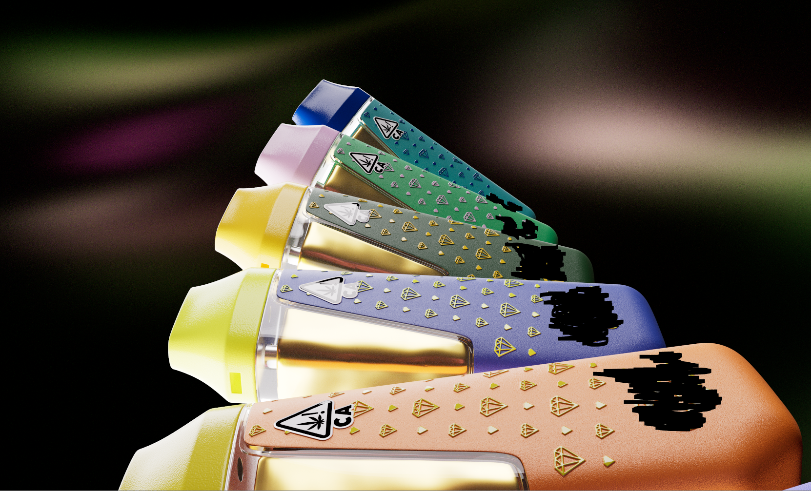

I am working on a project that I intend to render on the render network, however, some shots had weird artifacts, that only appeared after the ORBX export in standalone, but not in C4D LV or PV renders.
It's strange because earlier ORBX exports caused some ray epsilon-related issues that couldn't be completely resolved, as changing this parameter does influence it, but doesn't resolve no matter what value I try.
The similarity to that issue and this one is that they only show up in Octane Standalone after the ORBX export, but are gone if I were to render in C4D octane
The most interesting part is that exporting a single frame of the entire animation does not result in this artifact, and this works for up to a max of 10 frames, at 11 frames ORBX export to standalone the artifact would kick in, and rendering batches of 10 frames isn't ideal realistic for the length of the animation..
I haven't found a workaround let alone a solution so far, and narrowing down the troubleshooting process is slow due to having to export entire animations and render it in Octane standalone, additionally, my scene has quite a lot of very large textures, so exporting scenes to render also takes time, and leaving out the materials for the troubleshooting phase doesn't seem rational either, as the issue is isolated to a certain material/polygon selection.
So having run out of options, and out of hope for troubleshooting a bit, I turn to the forum as a last resort to proper help having tried Discord and Reddit to no avail.
my conclusions so far:
- feels ray epsilon related, not sure
- only shows up after exporting ORBX from cinema 4D and opening in Octane standalone

Artifacts after exporting C4D as ORBX

Fair to assume the unit is centimeters?Cromo wrote: the objects in the scene are about 15x80x30
Transparency happening at shading level, mix/layered such as a label on a bottle (typical scenario).Cromo wrote: What would you mean with an alpha texture file / node setup?
Judging by the provided screen capture of the kernel settings, the parameters haven't been setup appropriately according to the scene.Cromo wrote:https://render.otoy.com/forum/download/file.php?id=93952&t=1

In the ("Camera") Imager, is partial alpha disabled (default)?
The linked guide also shows double-checking pointers such as mesh intersecting, etc. Worth going through them all and ensuring everything is properly set.

There is some subtle specularity happening, and a 3-layer composite material that I can share as well.
Thank you for addressing the pointers in my kernel, I corrected those, but didn't fix unfortunately though
partial alpha is disabled in the camera imager yes.

A common trouble-solving process is to disable step-by-step each elements and test out to potentially pin-point the culprit.
Here, the shading (by large groups as shown on the screen capture, such as disabling the displacement entirely)

I remember having issues with linking nodes across materials in C4D years ago until Ahmet set me straight: Because of the way C4D works internally, each Octane node technically "belongs" to a specific material and no other. Because of that, there can be odd glitches as a node tries to pass info to nodes other than what C4D considers its owner. As such, there's a bit of a behind the scenes juggling going on during render time that's a little different when rendering to Octane in the host app vs. after the scene has been exported/recompiled as an ORBX.Cromo wrote:Node setup for 10 products each its own color variant on the same model, all nodes are connected cross-material, so 1 transform drives all the sticker decals for all color variation materials for easy changes, I don't know if this could be problematic potentially though
I wouldn't be surprised if your texture Displacement is especially sensitive to this issue.
If it turns out to be the multi-parented Transform node causing it, you might try linking attributes of multiple materials through an Xpresso node instead of trying to share one Octane node. I'm not sure how that gets translated into ORBX on export, but I've had luck with it.
Oh wow Frankmci, I think you nailed it on the head.
I did some tests turning off the displacement and it did remove the problem of the streaks.
However unfortunately ORBX export introduced some other glitches, which likely had to do with the cross-material connected nodes, this is something I did in an attempt to optimize as I thought more nodes or image texture consume more Vram.
Then the consideration to untangle this cross-material connected node system that involved 30 different materials just to make the ORBX export work (which wouldn't be guaranteed success) didn't seem a justified time investment being on a deadline.
