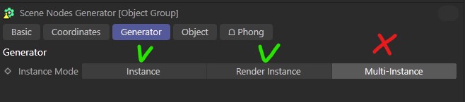

Scene node Object Group Generator doesn't work in Multi-Instance mode like Cloner object :
ObjectGroup_multiinstance.zip
(358.35 KiB) Downloaded 164 times
Cloner_0002.zip
(134.99 KiB) Downloaded 169 times
