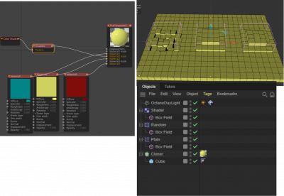

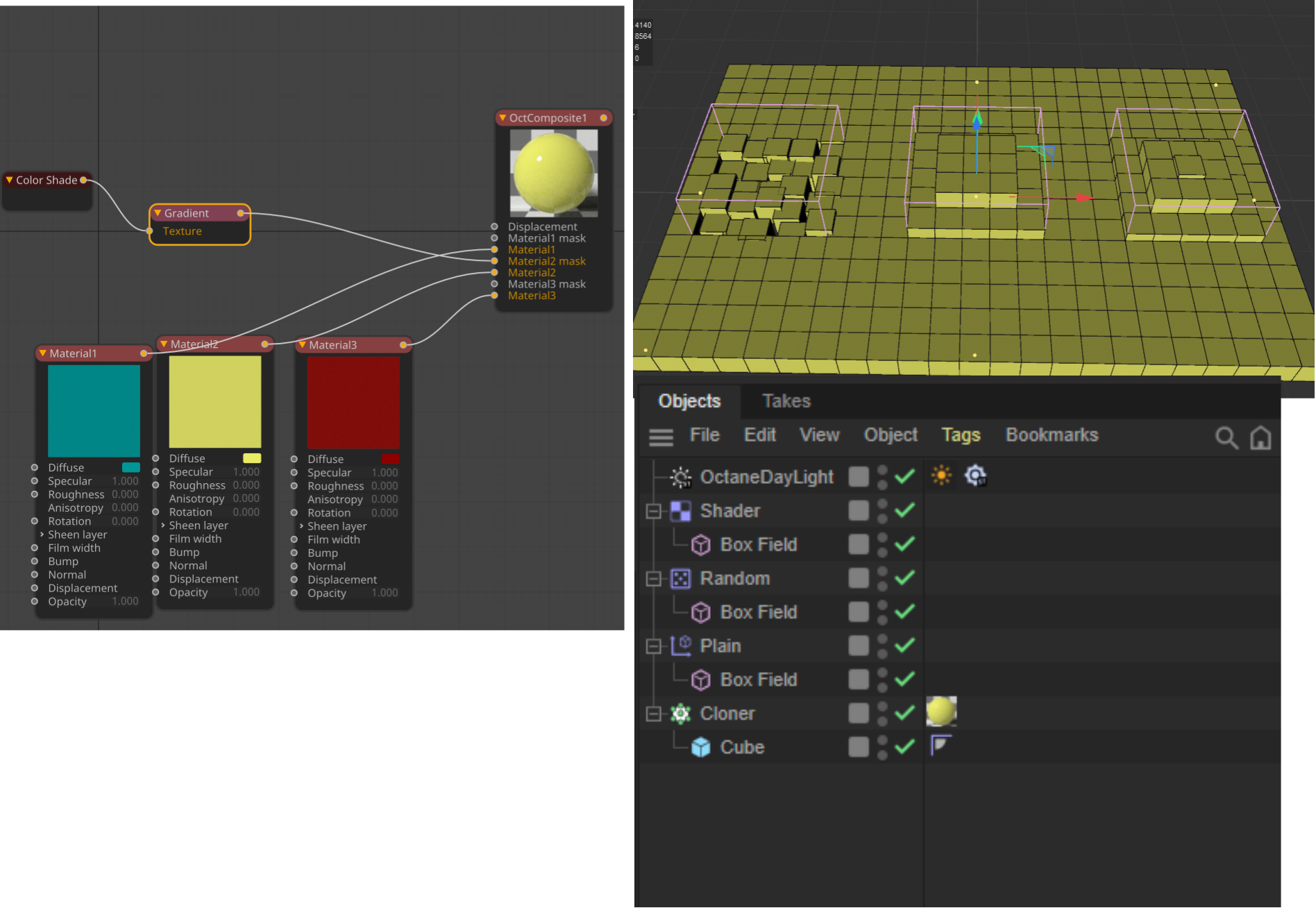

hi, how do I achieve different colors on the effector in octane? I have a cloner of squares being driven by different type of effectors, I tried to use the color shader into the composite material. is there a way to specific which effectors is tied to the color shader?

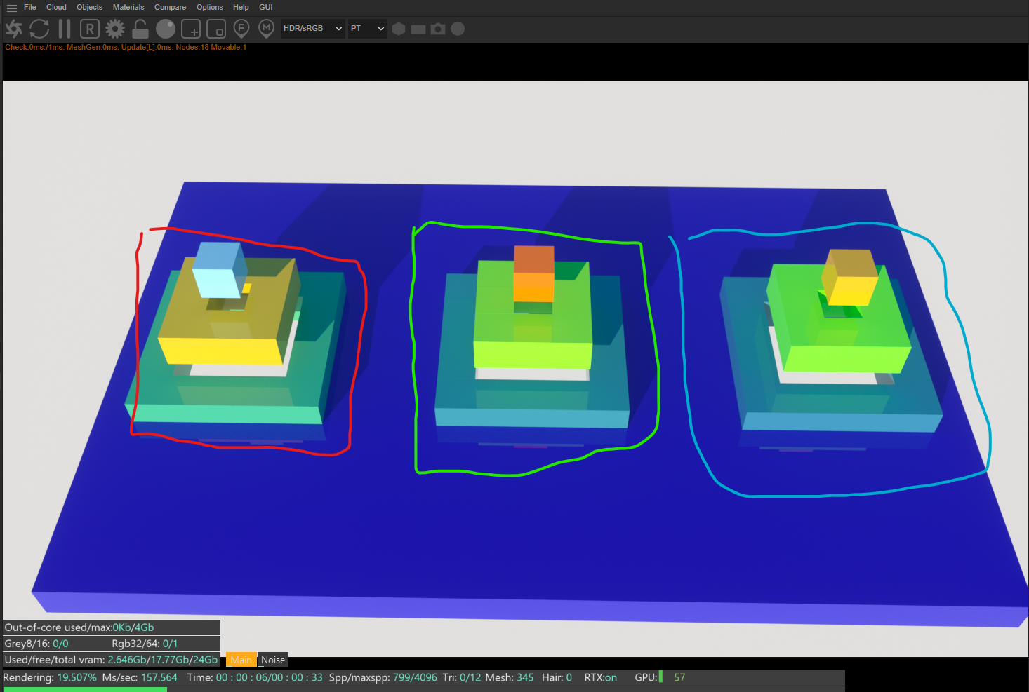

thanks for the tip and reply. Im not sure am I doing it right. I want to achieve having multiple effector/filed driving 1 single color on a cloner.
Each circle area represent 1 color each instead of random color

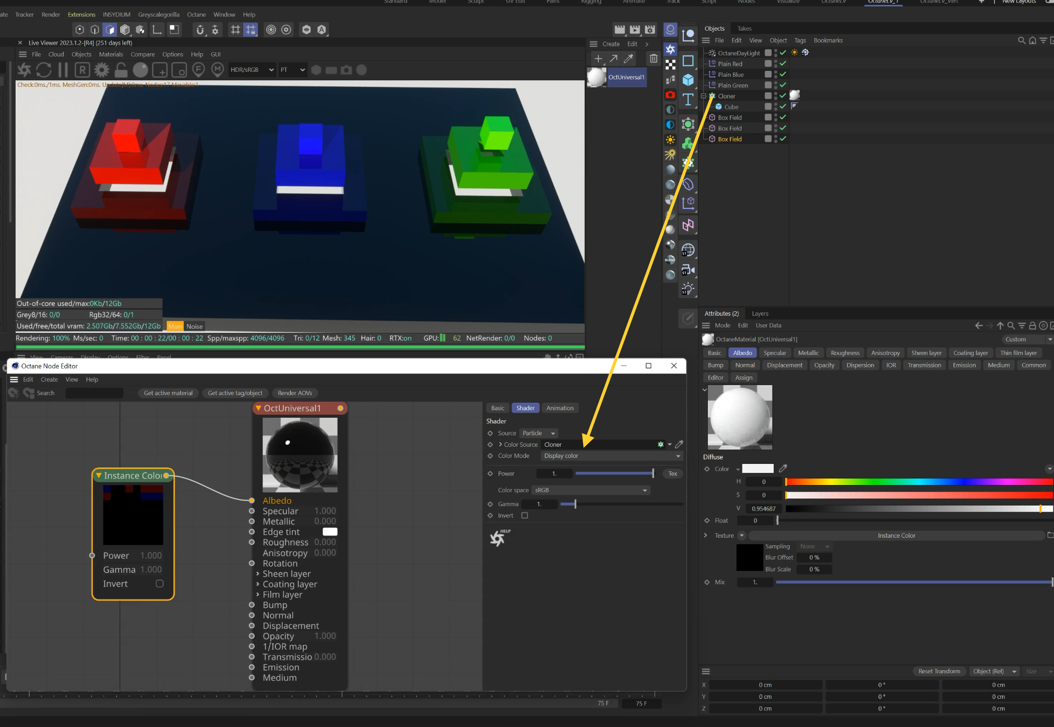

you need to use an Instance Color node in the material, and assign the Cloner as Color Source:
test c_b.zip
(206.52 KiB) Downloaded 61 times
