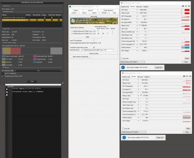

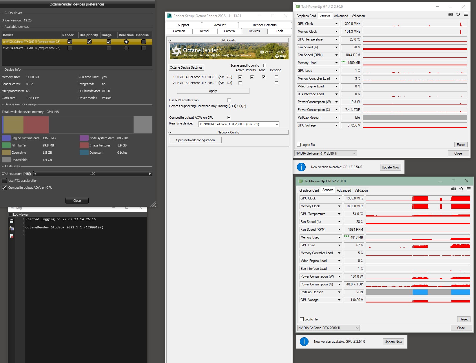

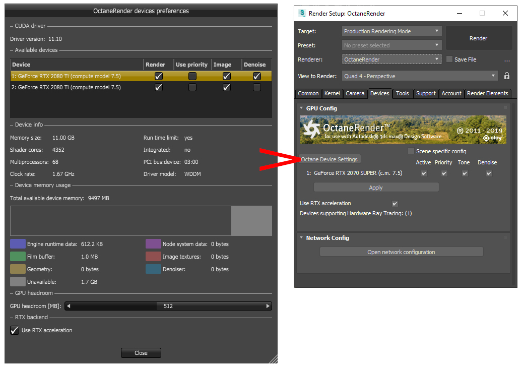

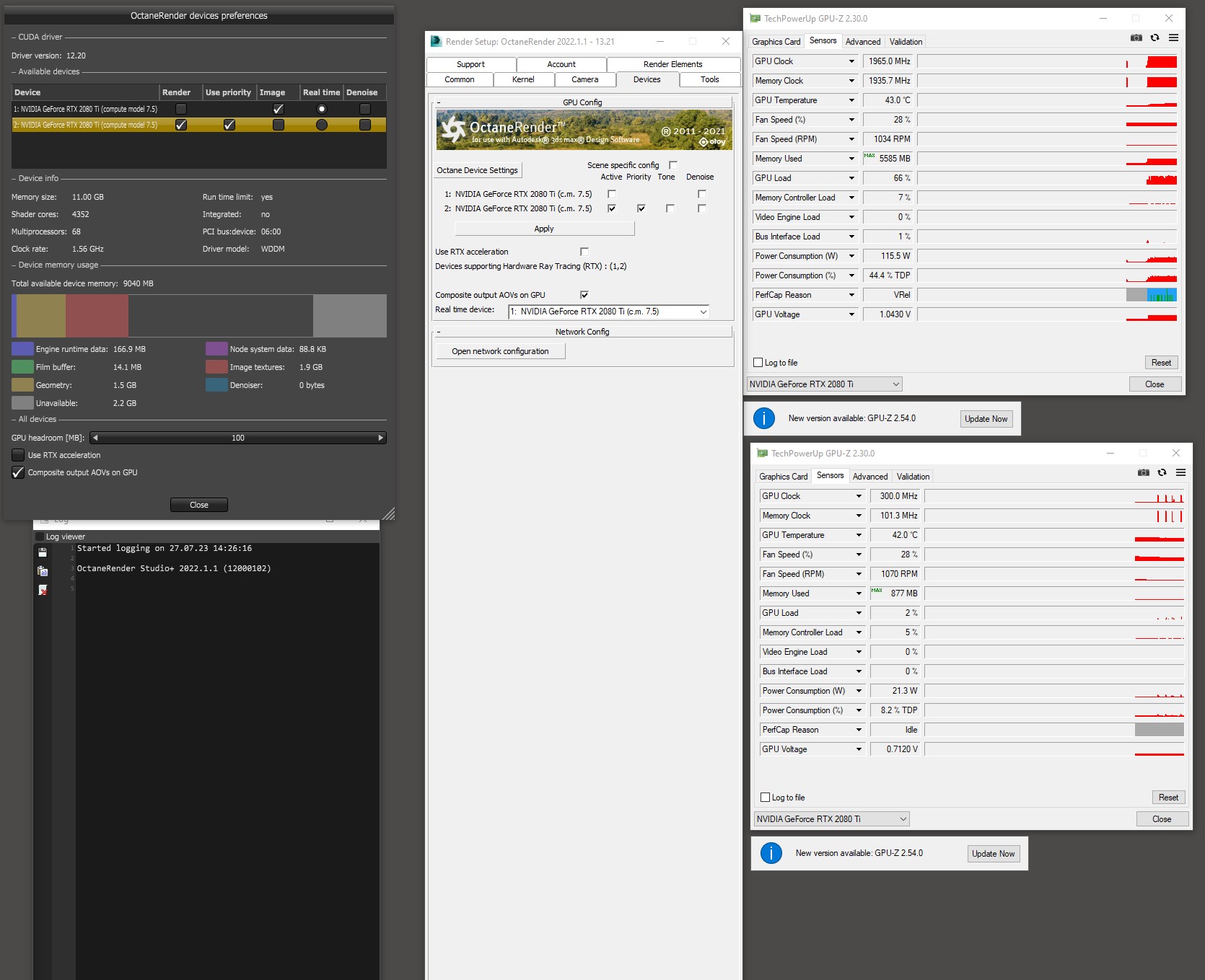

Ok. When I have the Octane devices preferences window open I'm unable to do anything else, like start a render. Is this normal? I got around it by opening it once the render had already started. Here's the results with the GPUs separately...
I tried turning RTX on whilst only having 1 card activated but it crashed Max.

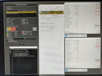

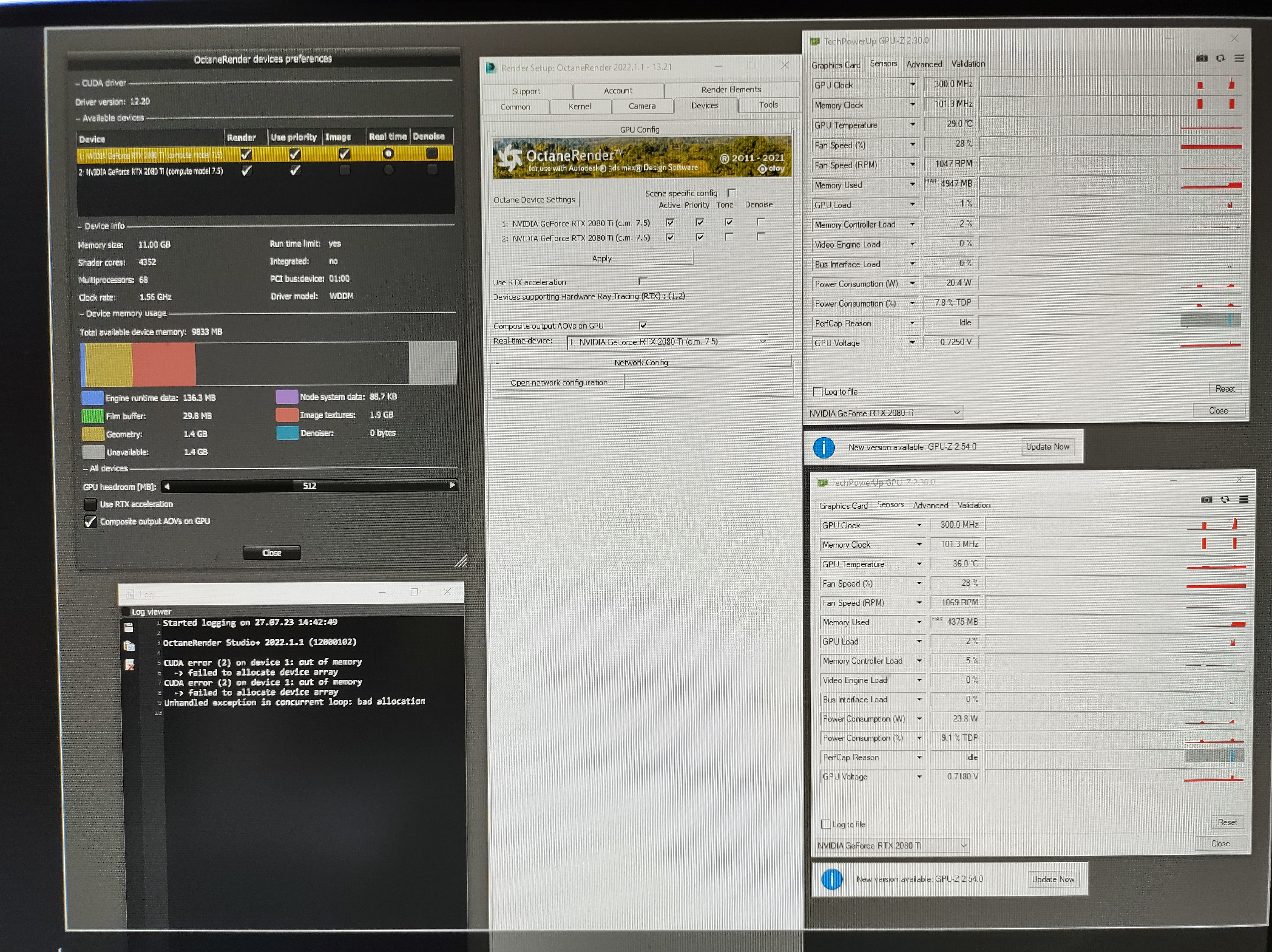

When I tried both cards activated, without RTX or denoising, it crashed as seen in the octane log. I tried to snip the info as normal but it froze the whole desktop so had to take a photo of the screen
Please let me know if you need anything else that may help

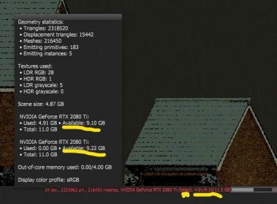

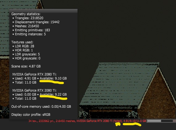

Yup.
OOC is set to 4GB but don't think it's required - if you look at the render stats info on the this image the gpu memory is only on 4.277GB and the cards have 11GB so don't see how it can be a memory issue.
This was rendered on 1 card as 2 just won't work.
When using Blender the 2 cards work no problem with Cycles.
I've also attached the detailed log which I'm hoping you guys might be able to use to work out what's the reason for the fails when using 2 cards...

Hi Rik,
Try setting the out-of-core to 8GB. I believe the issue might be related to this, as the first card is also handling the monitor/s, the operating system, and all applications that are using GPU resources.
Regards
Paride
Regards
Paride
