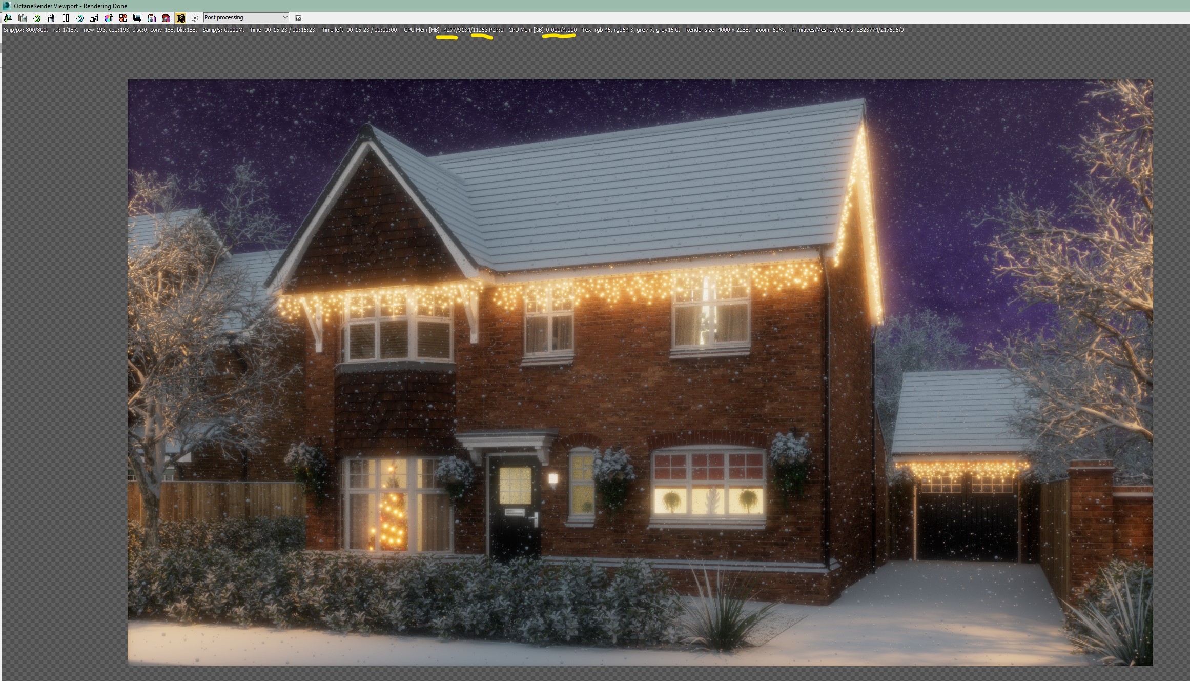

Rik
Posts: 423
Joined: Wed Jul 28, 2010 8:57 pm
Yup.
OOC is set to 4GB but don't think it's required - if you look at the render stats info on the this image the gpu memory is only on 4.277GB and the cards have 11GB so don't see how it can be a memory issue.
This was rendered on 1 card as 2 just won't work.
When using Blender the 2 cards work no problem with Cycles.
I've also attached the detailed log which I'm hoping you guys might be able to use to work out what's the reason for the fails when using 2 cards...
