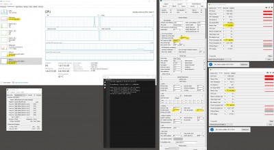

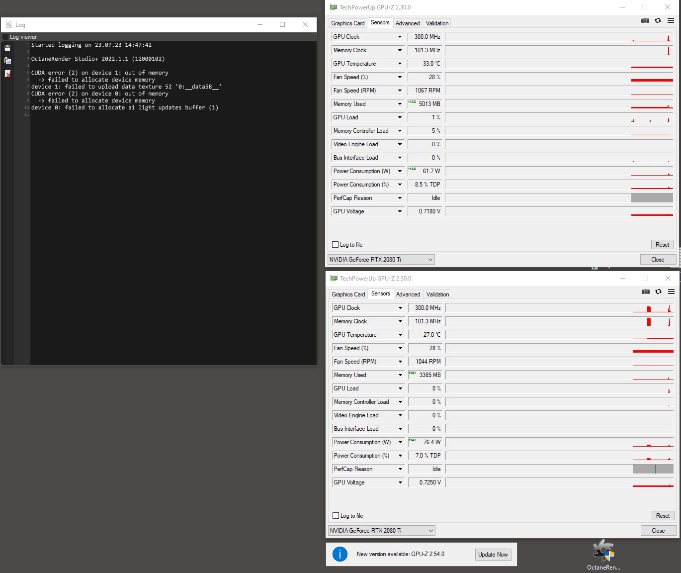

CUDA error (2) on device 1: out of memory
-> failed to allocate device memory
device 1: failed to allocate ai light updates buffer (3)
OptiX error for device 0: [ACCEL] Error launching command list (CUDA error string: out of memory, CUDA error code: 2)
Failed to build acceleration structure
OptiX API error for device 0: Device out of memory
OptiX error for device 0: [ERROR] "sbt->raygenRecord" is null
OptiX API error for device 0: Invalid value
device 0: RTX picking failed

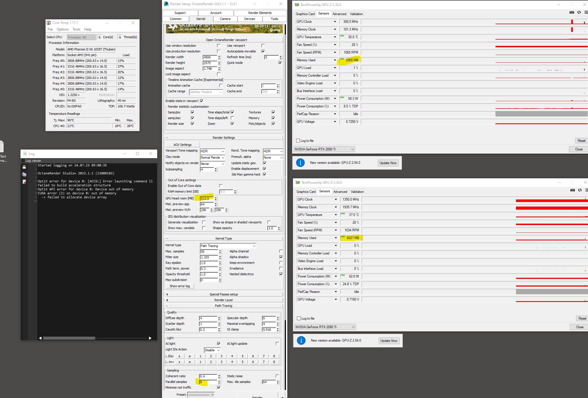

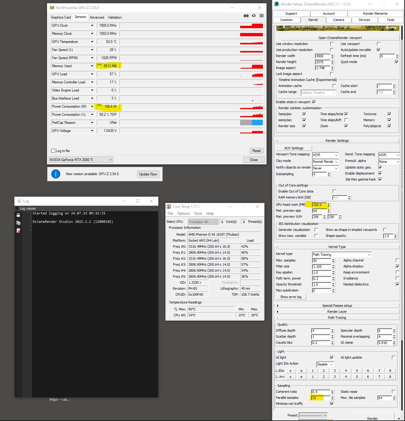

2 cards 8 parallel samples, fail
1 card 32 parallel samples, all good
Hi Paride
I did try that but it still crashes.
Don't understand why it will now only work properly with only 1 graphics card installed?
I can run a high res render, maxed out parallel samples and minimum GPU headroom no problem at all with 1 card.
When I put the other card back in it fails.

2 cards 1 parallel sample, 1 Max tile samples, GPU headroom 512mb, fail

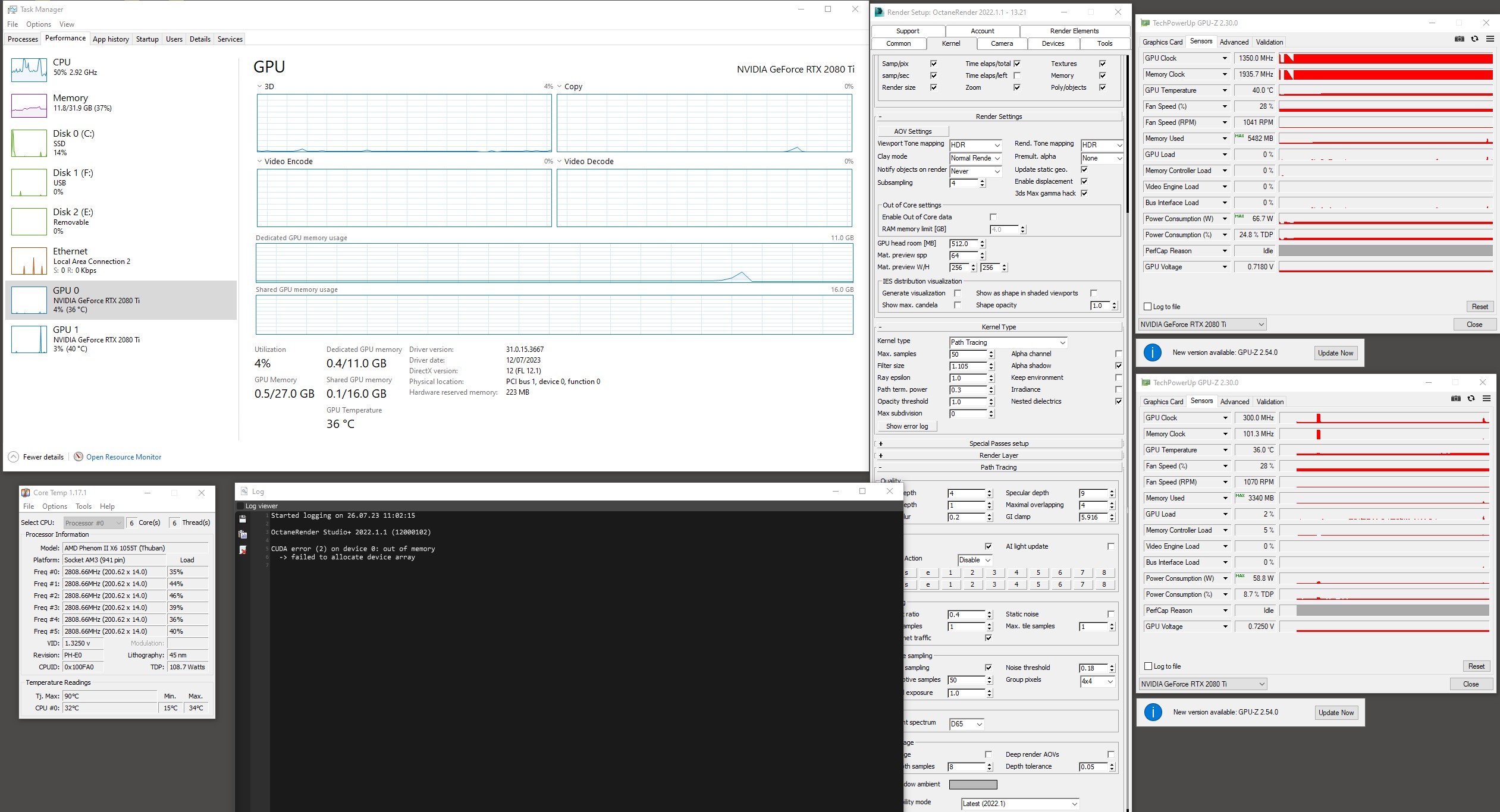

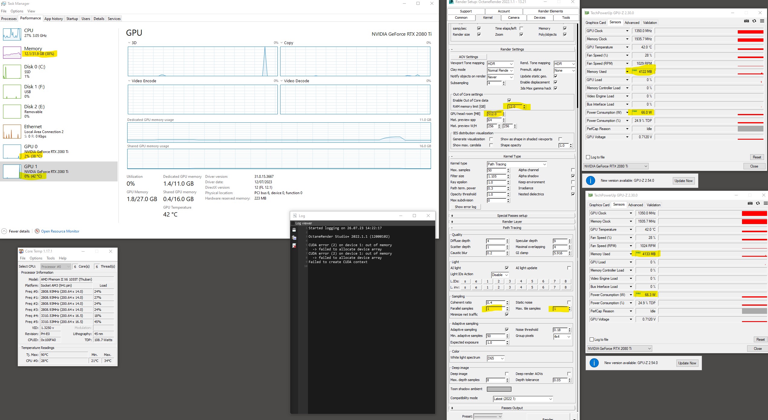

2 cards 1 parallel sample, 1 Max tile samples, GPU headroom 512mb, Out of core enabled, fail
Hi Paride, thanks for looking into this. Good to not feel alone!
RTX and denoiser were disabled for the previous failed render and this one.
This one also now has out of core enable, 12GB
Seems like the GPUs aren't getting the model fully loaded as when I use a single card it's shows about 8.5Gb whereas with 2 cards they don't load more than 4.13Gb each. That's about 1/2, almost as though Octane is sharing the model between the 2 cards.
Also, they don't get around to drawing any power. This can also be seen on the GPUZ panels.
Not sure how to show both GPUs at once in Task Manager? Though there's a load of info for them in the GPUZ panels.
