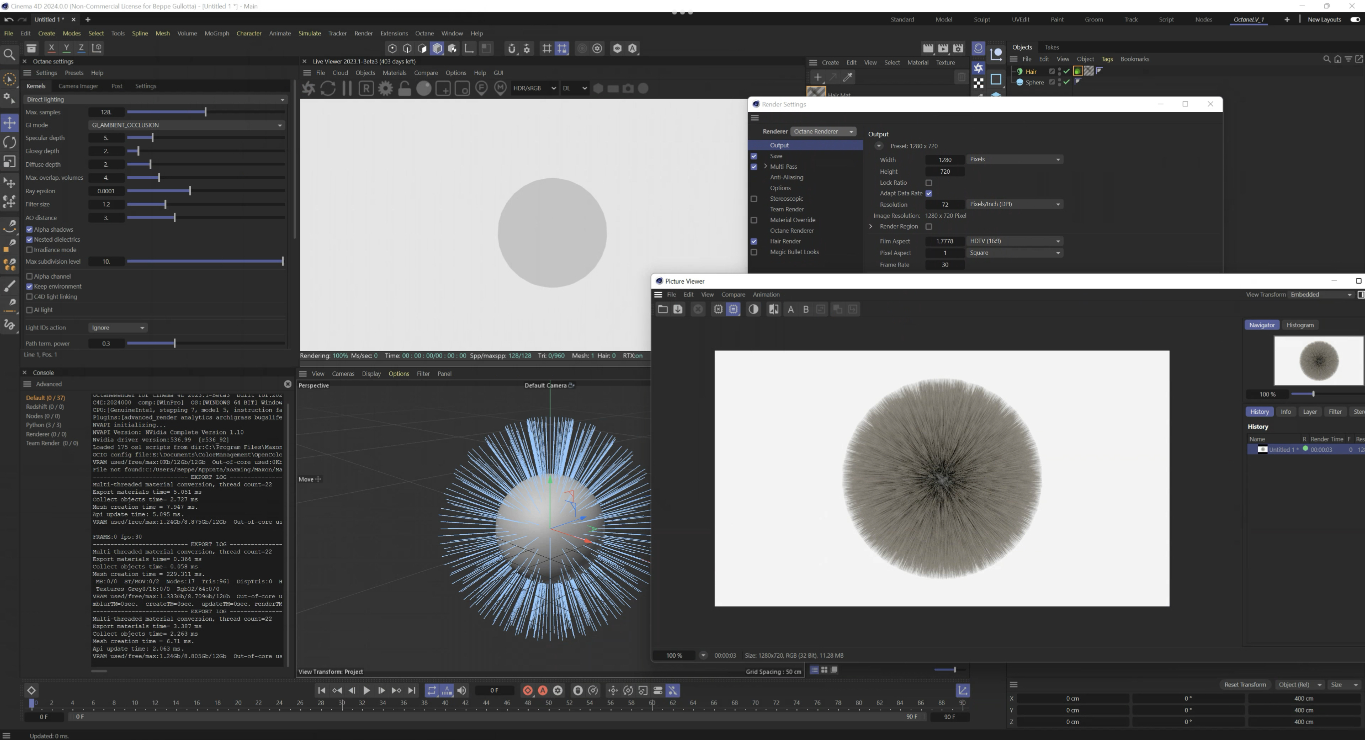

In C4D 2024, the Hair system is changed, and currently it is not visible in Live View, but it is working in Picture Viewer:

Be calm please, this is first working build for 2024 after work of weeks and we still collecting the feedbacks!
We found that hair is structured different against to previous builds of C4D. Now it works like fixed but we designed the plugin to work with old strange way, I'm fixing the problems after the feedbacks.
EDIT:
Here is the fixed build for hair object problem. Link has been updated.
