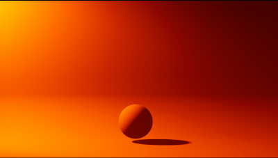

Im getting an issue with the post volume, it's creating a line at the center on the frame, this only happens when the camera is flat aligned with horizon, so when the camera got 0 angle at P and B rotation values, that line appears.
c4d2023.2.0 3090rtx RTX on

One question: Trying to get a beam in my analytic light using a post effect, but it won't show. Fog and glare work but the light beam won't show. Do I have to add a medium somewhere?

BCres wrote:Great release. Very Stable for me.
No medium is required. You need to Enable Light Beams in the Post Processing tab Volume Effects turndown of the Octane Camera tag. You also need to Enable Use Analytics in the Octane Light tag > Light Settings tab. In that tab is an additional turn down with options for Spread Angle, Spread Cutout Hardness, Falloff Radius and, most importantly, a checkbox to Use in Post Volume.
You can make the actual light source invisible to the camera using the Octane Light tag > Visibility tab settings, and still see the light beam effect.
Note: in the current build, you are limited to 4 light beams.

Thank you, Jay! It was that last most important point, the check box to "use in post volume" that I had not selected. Very much appreciate the help.
