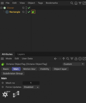

rgbjoy wrote:Thanks Beppe!
Two bugs I found:
If you add a spline with an ObjectTag to a cloner the hair tab disappears
also the hair with 1/1 thickness on any spline doesn't seem to be calculating correctly:
2022.1-RC3
How do you you say something is bug? Without defining something programatically that Will not appear magically. İt requires something is supported. Support your posts with better info like adding pictures which shows your setup or example scenes.

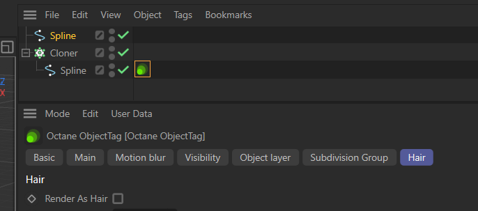

Simply adding a spline object inside a clone with the ObjectTag attached or attached to the cloner makes the Hair tab disappear:
This is in the latest C4D 2023.1.0. Here's a project file: https://www.dropbox.com/s/psp4ks93ta15z ... d.zip?dl=1

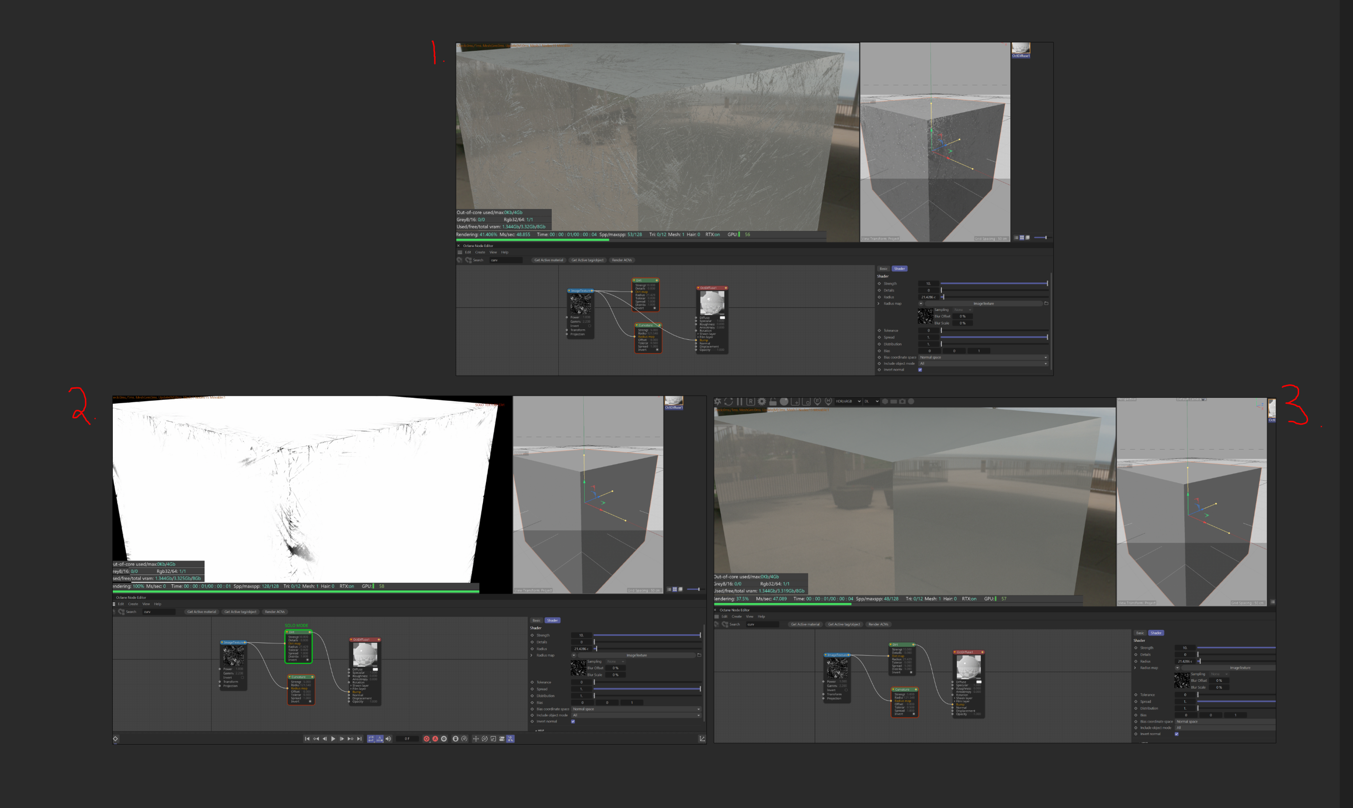

I believe I found a bug. It seems that I can't plug the DIRT or CURVATURE node into the bump channel. I recall this being available in previous version? Please see image.
1. with texture straight into bump
2. dirt map solo for visual
3. dirt plugged into bump channel, but no bump in render
thanks for all the hard work!

Mayahi wrote:I believe I found a bug. It seems that I can't plug the DIRT or CURVATURE node into the bump channel. I recall this being available in previous version? Please see image.
Have written about it some months ago without answer...
Did somebody figure it out how to force these nodes work in Bump channel?

rgbjoy wrote:Simply adding a spline object inside a clone with the ObjectTag attached or attached to the cloner makes the Hair tab disappear:
The attachment Screenshot 2022-11-30 at 5.55.28 PM.png is no longer available
As one data point, the Hair tab remains accessible for me, and renders as expected.
Octane Octane 2022.1 R2
C4D 2023.1.2
Latest NVIDIA Studio driver
Windows 11
... I take that back. Free-hand spline objects work fine, but the pre-defined spline objects do lose their Hair tabs.

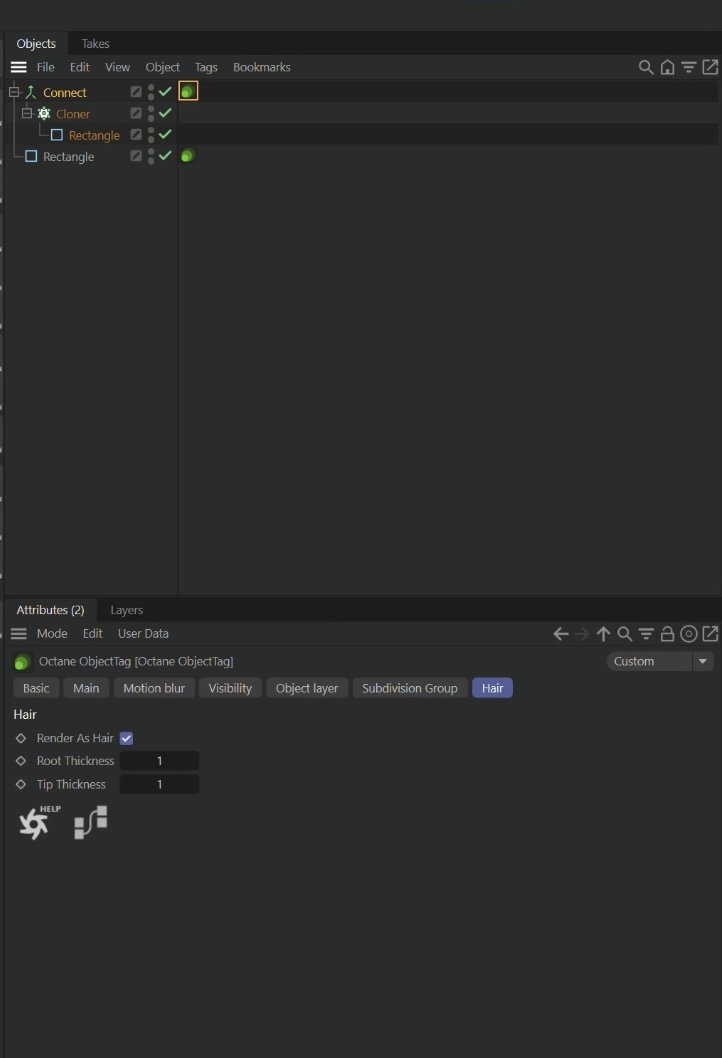

Cloned Hair Spline
Cloned Hair Spline
Posts: 10635
Hi Frank,

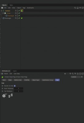

If you use a Connect object with Octane Object tag, before the Cloner, you don't need to freeze the spline primitive:
ciao,
Beppe
frankmci
Posts: 917
Location: Washington DC
bepeg4d wrote:Hi Frank,
Ah, nice! Thanks, Beppe. I don't think I would have thought of that. Do you know what the internal logic of it is? Is there something about the procedural curves that is "indeterminate" so the Octane Hair tag can't get its hooks in, but the Connect object "force bakes" the curve? I like to have a working theory of "Why" that may help solve future issues.
