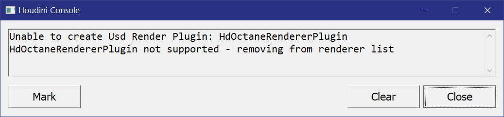

Do anyone else get this error?
yfripp
Posts: 18
Joined: Sun May 30, 2010 11:35 am
Terryvfx wrote:Do anyone else get this error?
I got this error when trying octane with the python 3.7 version of Houdini 19.5.368 - It goes away with python 3.9 Houdini 19.5.368
