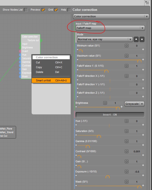

5. For the unfold, you could merge the duplicates ? Or maybe give us an option in the Octane preferences to either merge duplicates when unfolding or not. Btw. regarding unfolding, can you check if you are able to unfold the Color Correction node ? I had assigned a Falloff map as input but if I unfold the Color Correction node, it does not unfold.
Falloff map will not unfold from a Color Correction node when clicking Smart unfold.

rajib wrote:5. For the unfold, you could merge the duplicates ? Or maybe give us an option in the Octane preferences to either merge duplicates when unfolding or not. Btw. regarding unfolding, can you check if you are able to unfold the Color Correction node ? I had assigned a Falloff map as input but if I unfold the Color Correction node, it does not unfold.
I recently removed the merging behavior of "Smart Unfold" because it was buggy and I think it was overly enthusiastic about what it was merging. Can you say a bit more about your workflow to help me understand what you want the merging for? For example, how do you end up with duplicates in the first place?
As for why the Falloff map is not being expanded, I think it's falling afoul of the logic used to determine whether it's worth expanding. In this case, the Falloff map fails the test because all of its inputs are "values" (enums and ints). I guess that it would make sense to always expand nodes with a texture output.
