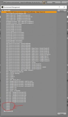

3. Thank you for the environment deletion list. I had asked for that a long time ago and though Paul had added the deletion button it was a pain to use when there were a lot of environments imported for the scene. Your current implementation makes it a breeze to delete the old and not needed environments. Btw. there are a couple of bugs I found in it:
i) I see multiple 'Output' nodes/environments listed in the list. Attempting to delete them resulting in a crash. I think those are internal to Octane. Can they be hidden from the list so that no one accidentally attempts to delete causing a crash ? ii) Also in the above Image, the name in the drop down HDR Texture Environment - HyperfocalDesign (2) (2) (2) (2)... is not listed in the deletion list with same name. One of the HDR Texture Environment - HyperfocalDesign in the list refers to it. Making it difficult to figure out which one is the current one. Can the current one be made bold or italics in the list so that it is not deleted by accident or at least it allows us to see which one is the current one as the name does not seem to match up.

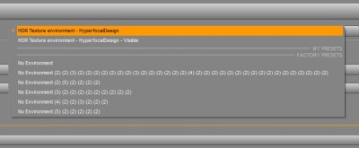

iii) Can the multiple No Environment list be also cleared ? This is shown when one clicks on the Environment Selection drop down. 4. Thank you for adding all the missing Node types, specially the Material Layered Group node.

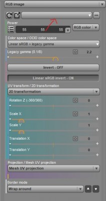

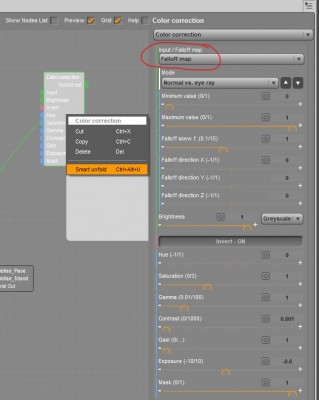

Can you fix this long standing bug - If the image file path has an & character, Daz can load the image, but the Octane plugin cannot. That is actually a valid character for Windows file path. 5. For the unfold, you could merge the duplicates ? Or maybe give us an option in the Octane preferences to either merge duplicates when unfolding or not. Btw. regarding unfolding, can you check if you are able to unfold the Color Correction node ? I had assigned a Falloff map as input but if I unfold the Color Correction node, it does not unfold. Also, can you please take a look at the this thread where I had listed many of the bugs / issues I had found before - viewtopic.php?f=44&t=72407.

This bug should be fixed as of 2021.1.5 - 70 (viewtopic.php?f=44&t=80166)rajib wrote: Issues :
Can you confirm you're still having this issue when you save and load a new scene?

That's definitely a bug, possibly related to the issues of the names in the deletion list not matching exactly the names in the selection list.rajib wrote:Some of the issues I have highlight over the years seems to have been resolved. Specially the big ones like :
Highlighting the current environment is a great idea, I'll add that to my list of improvements.rajib wrote:ii) Also in the above Image, the name in the drop down HDR Texture Environment - HyperfocalDesign (2) (2) (2) (2)... is not listed in the deletion list with same name. One of the HDR Texture Environment - HyperfocalDesign in the list refers to it. Making it difficult to figure out which one is the current one. Can the current one be made bold or italics in the list so that it is not deleted by accident or at least it allows us to see which one is the current one as the name does not seem to match up.
The problem with these duplicate No Environment entries is that they are classified as "Factory Presets". I fixed the problem that was causing them to be created in the first place, but allowing their deletion is potentially tricky. I'll have a look into it.rajib wrote:iii) Can the multiple No Environment list be also cleared ? This is shown when one clicks on the Environment Selection drop down.

I recently removed the merging behavior of "Smart Unfold" because it was buggy and I think it was overly enthusiastic about what it was merging. Can you say a bit more about your workflow to help me understand what you want the merging for? For example, how do you end up with duplicates in the first place?rajib wrote:5. For the unfold, you could merge the duplicates ? Or maybe give us an option in the Octane preferences to either merge duplicates when unfolding or not. Btw. regarding unfolding, can you check if you are able to unfold the Color Correction node ? I had assigned a Falloff map as input but if I unfold the Color Correction node, it does not unfold.
As for why the Falloff map is not being expanded, I think it's falling afoul of the logic used to determine whether it's worth expanding. In this case, the Falloff map fails the test because all of its inputs are "values" (enums and ints). I guess that it would make sense to always expand nodes with a texture output.
