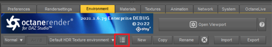

  • [NEW] Added a bulk delete dialog for rendersettings and environments
    Please take a backup of your presets database before playing with this. You can find the database file at C:\Users\<username>\OctaneRender\Data\OctaneRender_presets.oczdb.

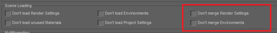

  • [NEW] Added two options to control whether render settings and environments are imported when merging a scene.

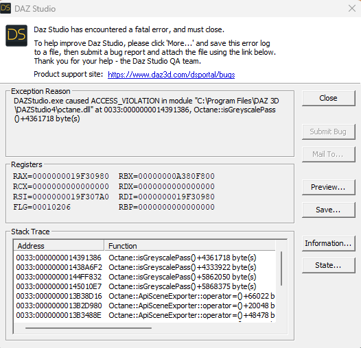

Also I don't know if this is anything you can look at but I've been getting this crash from daz lately

Sorel wrote:Also I don't know if this is anything you can look at but I've been getting this crash from daz lately
Please save the crash dump and attach it. Also, make sure to let me know the exact version and edition you're using, e.g. 2021.1.6_83 Enterprise, and what you were doing when the crash occurred.
If you're willing, it would make it easier for me to track down if you could create a crash dump using one of these debug builds:

Here's the zip that I sent to daz that has the log and dump files. I'll try the debug version tomorrow. Also using this latest plugin and daz 4.21, although it was doing it on 4.20 as well. And it seems kind of random when it occurs. One time I was just moving the viewport and it crashed. Another time I was editing a material and it crashed.
DAZStudio_error_report_221013-232645.zip
(159.45 KiB) Downloaded 240 times
toby_a
Posts: 261
Joined: Tue May 10, 2022 11:59 pm
Sorel wrote:Here's the zip that I sent to daz that has the log and dump files. I'll try the debug version tomorrow. Also using this latest plugin and daz 4.21, although it was doing it on 4.20 as well. And it seems kind of random when it occurs. One time I was just moving the viewport and it crashed. Another time I was editing a material and it crashed.
Thanks for that. It looks like the crash occurred in one of the threads created by the Octane DLL. There is no plugin code involved in that thread, so I can't say much more about it. Please post a crash dump from the debug version if it happens again.

Thank you, this confirms that the crash is happening inside the Octane DLL.
Next step is to enable extra Octane debug output. Please create a file called octane_log_flags.txt in the DAZStudio4 directory (the same location as octane.dll) with the following contents:
Code: Select all
logToFile
logForceFlush
logTime
logPrefix
apiNodeSystem
apiRender
apiChangeMgr
apiExport
apiForceConnectChecks
apiNetwork
appShutdown
This should cause a file called octane_log.txt to be created in the same directory. If the directory is not writable then the file will be created in the directory identified by the TEMP environment variable. You can browse this directory by entering %TEMP% in the location bar of Windows Explorer.
Please send me the octane_log.txt file after a crash happens (the file is overwritten each time you start Daz, so make sure to copy it before restarting).
Note that this extra logging will slow the operation of the plugin down significantly, so you will probably want to remove the log flags file when we've gotten to the bottom of this.
Thanks,
Toby.
