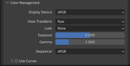

Maybe those settings work fine for you, but are not the best option.
1. Best Color Management settings:
* Display Device: sRGB
* View Transform: RAW
* Look: None
* Exposure: 0.0
* Gamma: 1.0
2. Go to camera tab in Properties window and enable Octane Camera Imager (Render mode)
3. Alternatively go to 3d view Properties panel (N key shortcut), locate Octane Camera Imager (preview Mode) and enable Override. This way all cameras will have the setting from this panel.
Camera Imager for preview should be set to sRGB.
Then is up to the user to decide to save the images in sRGB or Linear.

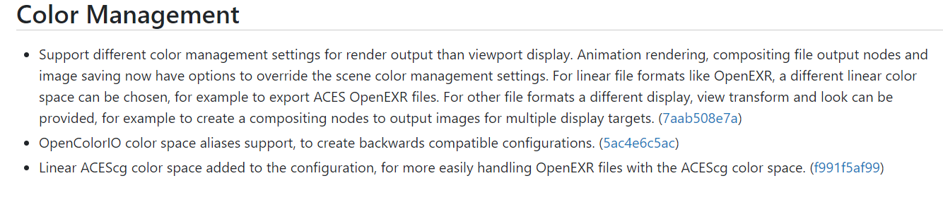

Looks like Blender 3.2 has color management options for the Image -> Save As window. So this issue should resolve itself whenever Octane is updated for 3.2.
tapanojum
Posts: 34
Joined: Tue Dec 18, 2018 5:17 am
I think/hope that they've addressed that issue in 3.2.
https://wiki.blender.org/wiki/Reference ... 3.2/Cycles
2022-06-17 17_32_07-Reference_Release Notes_3.2_Cycles - Blender Developer Wiki - Brave.png
