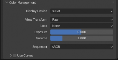

1. Best Color Management settings:
* Display Device: sRGB
* View Transform: RAW
* Look: None
* Exposure: 0.0
* Gamma: 1.0

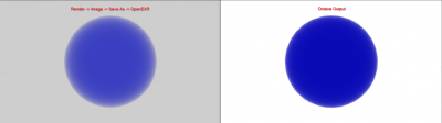

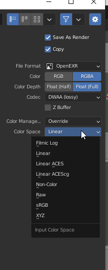

If I save the file via Octane Output, I get a correct EXR but this method seems to be prone to overwriting. Every time I hit F12 to render, I will be overwriting the saved EXR.
F12 Render -> Image -> Save As -> OpenEXR, I get an EXR with Filmic Log Encoding already applied. Side by side comparison
I want to save the sRGB Raw via Image -> Save As while having Octane Camera Imager(Preview Mode) display the Filmic Log Encoding in the viewport, how can I do it? Sorry for resurrecting an old thread.

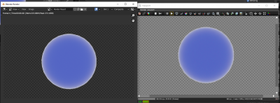

I'm sorry but I may not be understanding your comment correctly. I already have my color management set up as described in your blog. My issue is that saving an EXR through blenders (F12) Render -> Image -> Save As -> OpenEXR gives a different image than saving the EXR via Octane Viewport or Octane Output.
The Viewport, (F12) Render view and the Octane Viewport render all show the same image. EXR Saved from (F12) Render -> Image -> Save As -> OpenEXR EXR saved from Octane Viewport My goal is to have an EXR saved from Blender's native render window be the same as an EXR saved from Octane's viewport window in Linear. Just to avoid any confusion, by Octane Viewport I mean the "Show Octane Viewport" found in render settings.

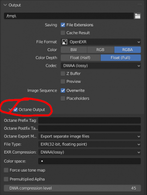

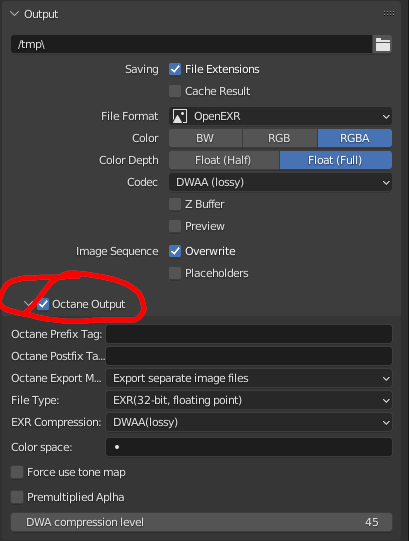

I considered this option but found myself constantly overwriting renders. My viewport settings are often different than the final render, so testing how different changes look with F12 results in overwriting prior saves if you're not careful. So far the most convenient method for me is to simply save via Octane Viewport, which unfortunately crashes in the 2022.1 XB1 version.elsksa wrote:Ed O'Connell (llennoco) mentioned to enable the Octane output option to save the EXR directly.
Thanks for asking about this on the Discord, Elsksa.
